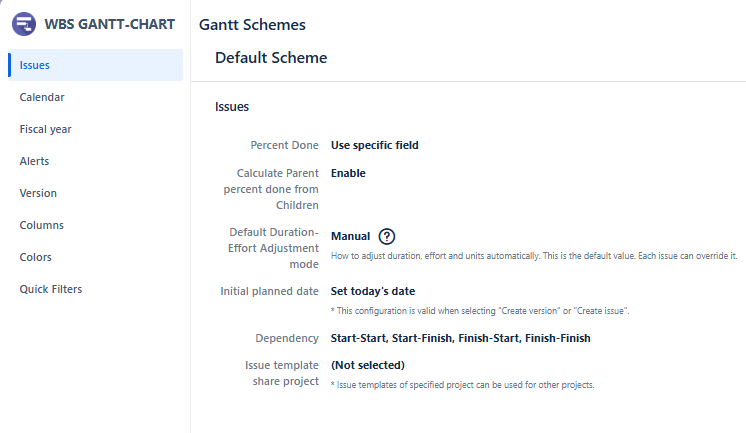

Unfortunatily, it looks like I cannot view, let alone adjust the assosiaction of dates and fields, since this is configured by some amdin in the big company I guess. At least I don't see the "issue" button, that you showed me, or is there a trick?

KINAY Mizuho[Ricksoft]
April 11, 2025
Hi Kapmeyer,
Thank you for your reply.
You are right, the screen is only visible for Jira admin.
This is because this configuration is for entire site. So you cannot change field to use for start/finish date only for your project.
Could you contact Jira administrator in your company if they can check the configuration ?
April 10, 2025
Hi @Kapmeyer, Jens and @Marc -Devoteam- ,
My name is Mizuho from Ricksoft support.
Jens, thank you for using your app.
Marc, thank you for helping out here. I agree with you that the field used for start/finish date are different between timeline and WBS Gantt-Chart.
Here I just commented because I wanted to introduce where users can find which fields are used for Start/Finish date in WBS Gantt-Chart.
Please navigate to Cog icon > "Apps" > "Issues" under WBS Gantt-Chart.
You see the field association between the app field and Jira field.
For example in the screenshot below, it uses "Start date" field for start date and "Due date" field for finish date.
If these fields are the same for timeline start/finish date, the date should reflect between timeline and WBS Gantt-Chart.

Kapmeyer, Jens
April 11, 2025
Hi Kinay,
thank you for advising me.
After some searching I found this page, where the GanttChart adjustments are located I guess. But there is no start date end end date assosiation as I see ...
Best regards, Jens
