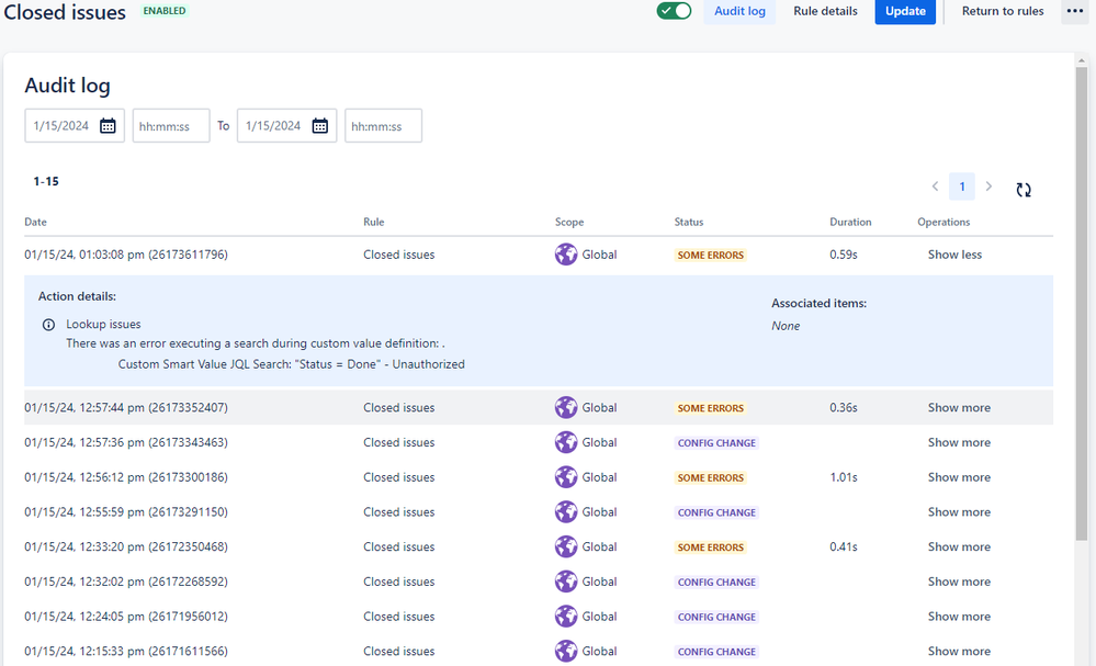

I get This error when looking up issues by JQL in an automation:
BUSCAR INCIDENCIAS
Se ha producido un error al ejecutar una búsqueda durante la definición del valor personalizado: .
Custom Smart Value JQL Search: "Status = Done" - Unauthorized

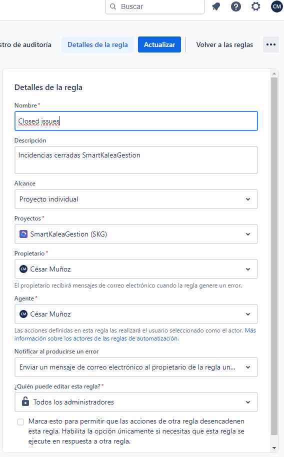

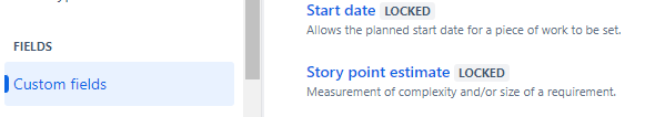

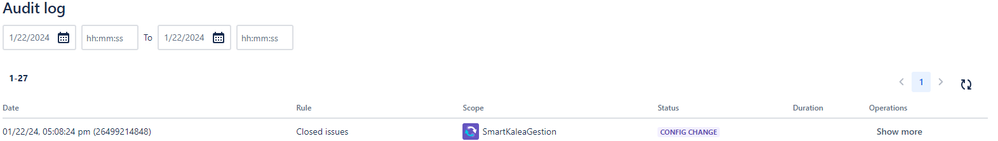

I have reviewed the custom fields, and I don't see any "Status" field. I attach the corresponding screen image showing no fields among "Start date" and "Story point estimate" (where any field starting with "Status" should be) in the alphabetical custom fields list.

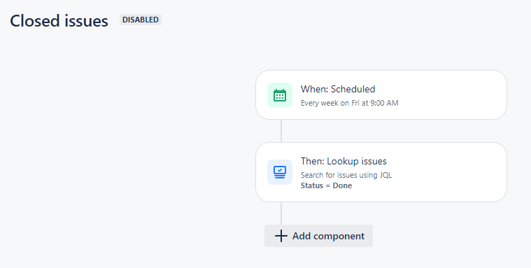

I've tried to configure the automation with an admin user (I attach the rule details screen image). But when I press on run rule, no execution is registered in the audit log (I attach also screen image).No_executed_rule.pngDifferent_user.pngNo_custom_status_field.png

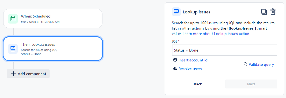

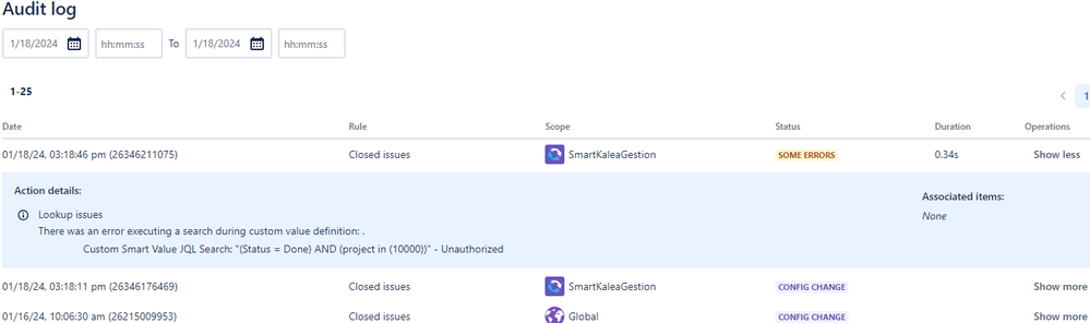

Can you provide screen images that show us all the steps in the rule, the details of the step where the JQL is being used, and the complete details from the Audit Log for the rule execution?
Admin Jira SQS
January 15, 2024
Hello Trudy.
Thank you for your interest.
I attach the required screen images. Of course, you can ask me for any other image or information you could require.

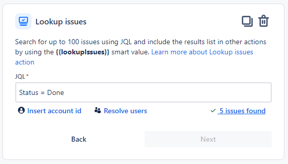

What happens when you click Validate Query in the Lookup Issues step?

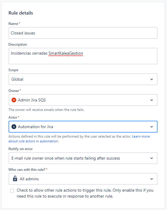

Who is listed as the Actor for the Rule on the Rule Details page?

The validate query returns OK with 5 issues found (see attached image).
The Actor for the Rule is "Automation for Jira" (see attached image).
The project scope for the rule is "Global" (see attached image). This Jira only has one  project created.

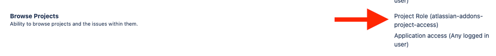

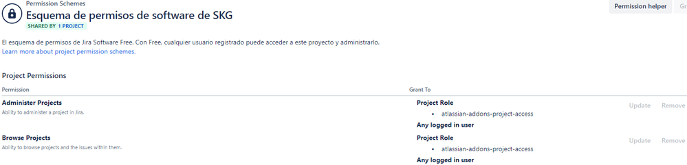

Check the permission scheme for the project. Confirm that the Browse Projects permission is granted to
  • Project Role (atlassian-addons-project-access)

In the permission scheme for the project, the Browse Projects permission is granted to
Project Role -> atlassian-addons-project-access. I show you the snapshots.
