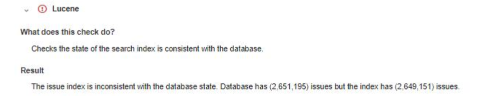

Hello, we performed a reindex a few hours ago in an attempt to get rid of this error.
Our "Create new issue", "add comment" alongside other actions take a long time to go through and we suspected that this was the reason.
Server Version 7.2.3
Thank you for all and any input about our problem...

@Viva Bot , Indexing and troubleshooting index problems can be tricky. Here are two articles from Atlassian with suggestions and troubleshooting support:
https://confluence.atlassian.com/jirakb/troubleshoot-index-problems-in-jira-server-203394752.html
https://confluence.atlassian.com/jirakb/lucene-search-indexes-health-check-fails-in-jira-server-740263412.html
The first is a general guide while the second is a bit more specific to what you are seeing.
You indicated that you have performed a reindex. Was it a back ground reindex? if so try a lock and rebuild. I have also had success in the past deleting the index completed and allow Jira to re-create all the associated directories & files. (backup the existing index first just in case).

Thank you, we did a lock and rebuild but it didn't help.
Those are exactly the articles we were viewing yesterday actually before deciding the lock and rebuild reindex.

Hmmm. Have you opened a support ticket with Atlassian Directly. Also, look at your plugins - are they up to date? One of those guys could be the culprit.

The last time we got stuck with an Index issue it was due to an add-on, here is what we did. Maybe this will help:
  1. Back-up you existing Jira Index.
  2. Put Jira into safe mode. This disables all apps.
  3. Shut-down Jira and manually delete the index files/folders. Jira will re-create these the next time it builds the index.
  4. Start Jira and rebuild the index. The only option you should have is lock & reindex.
  5. Take Jira out of safe mode.
  6. Restart Jira
  7. Lock & Rebuild the index to add all of the app data in.
Enabling safe mode:
https://confluence.atlassian.com/upm/disabling-and-enabling-apps-273875716.html
