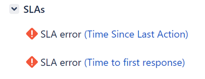

Since our recent upgrade from version 8.13.6 to 8.20.7 some service desk issues that should not be calculating SLAs are displaying "SLA error" for 2 defined SLAs. Any idea what's going on?

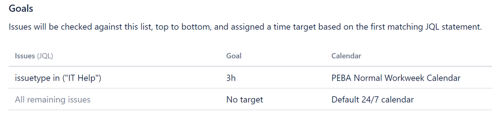

Since you mentioned the error is for the issues that should be excluded from the SLA calculation, check the JQL queries used in the goal conditions to see if anything changed. Whether running the same query in issue navigator works fine?

Thanks - yes, I tried modifying and saving the SLAs, which reported no errors nor resolved the problem. Nothing of note in the log file. Very simple JQL, which hasn't changed. It should limit (and always has until the upgrade) SLA calculation to one particular issue type, but now it's applying to another issue type. Thanks for your ideas and recommendations.
