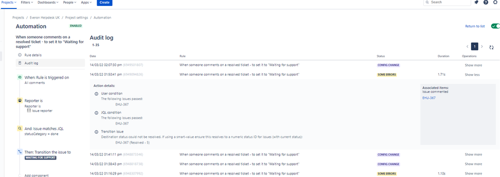

Hey @Richard Hosier ,
At a quick glance that rule looks ok. Can you check the Audit of that rule to see if it triggered and what the outcome was?
you should be able to see it on the Rule details.
Allright so the error message says that the transition cannot be resolved.
Can you validate that the transition is possible from Resolved -> Waiting for support?
The error message hints towards the fact that it isn't :) (maybe see if you can do it manually?)
Well if you open a ticket that is Resolved, can you manually put it back to Waiting for Support?
If not, you'll have to check your workflow to see if the transition even exists between Resolved -> Waiting for Support OR if there are any restrictions on the transition.
Aha! I can`t change a "Resolved" ticket to "Waiting for support".
I guess that`s why!
I need to add this option in the flow.
Would you know how to add the work flow of "Resolved" to "Waiting for support"?
