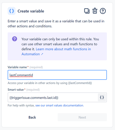

My automation has a branch with a JQL rule used to select related issues and iterate over them. Before entering that branch I'm adding a new comment to the trigger issue (which is that main epic issue) and then within the branch I'm cloning certain issues and link them to that epic issue, where the comment was added earlier in this automation, and would like to update that comment with a full list of issue keys for all the cloned issues.
I'm aware that this type of branches are running as separate processes and I will not be able to see "createdIssues" list outside of the branch. Hence I decided to try the solution with adding a generic comment first (before entering the branch) and then within that branch update that comment using its ID.

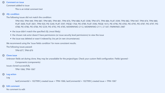

According to the logging initial comment is being added successfully, it's ID is being assigned to a variable, variable's value is present when inside the branch, "createdIssue" smart value works as expected within the branch, BUT when it comes to the Edit Comment action, where I use the "Smart Value" to refer to the comment ID to be edited, it produces the same "No comment to edit" error in the log despite of whatever I try to put there in the comment text (tried both dynamic and static text values there).

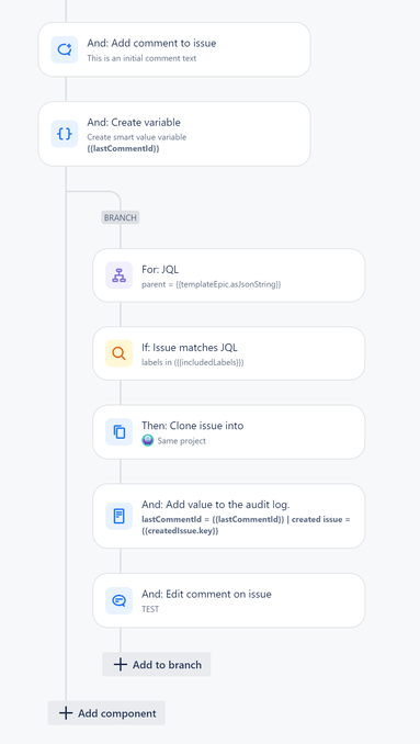

Here is that part of my automation:
Here are the parameters of certain actions from the automation above:

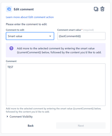

This is an example of an Edit Comment action with just a simple text "TEST" to illustrate that even that one is leading to this "No comment to edit" error:
This is an original Edit Comment action, where I was expecting the initial comment to be updated with the list of the keys of the cloned issues:
And here is what I see in the logs after running the automation (comment ID logged here is a valid one and it corresponds to that initial comment, which was added prior to entering the branch) :

After adding the comment to what appears to be the trigger issue, the rule then creates a variable named lastCommentId to capture the id.  But that is the last comment added from the time the rule triggered, and not from the last action.  Please add a Re-fetch Issue action after adding the comment and before creating the variable to get the latest, last comment's id.
The branch on JQL is to a different issue than the trigger issue, and inside there is an action to edit a comment, referencing the saved variable...which is a comment id for the trigger issue's comments.  The edit comment action is in the context of the "current issue", which in this case is the branched-to issue.  I do not believe the action can arbitrarily access any comment as the REST API function does not support that.
I also thought so but it actually works like a charm without re-fetching :) I did quite a bunch of test runs while logging the value of this lastCommentId variable right after the Add Comment action and every time this variable was having an id of the newly added comment from that action right before the logging one.
I did some more experiments and also accidentally discovered exactly what you described above: when inside the branch any Add Comment actions are adding comments to the issue(s), which are being iterated through according to that FOR loop of the branch.
That's understandable and it's my bad to assume that Edit Comment action inside that branch would be able to "see" and edit a comment on the triggerIssue from the main execution path of this automation.
