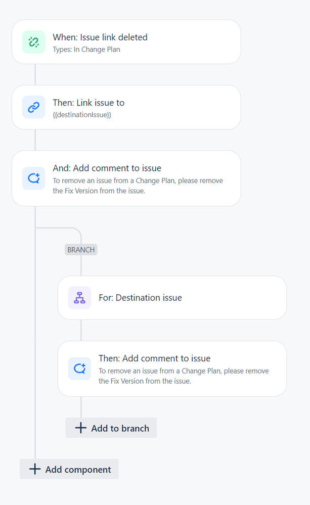

I just solved this by creating an automation that is triggered by a deleted link.
The automation adds the link back and adds a comment to both source and destination issue to communicate to the user why this is happening.
