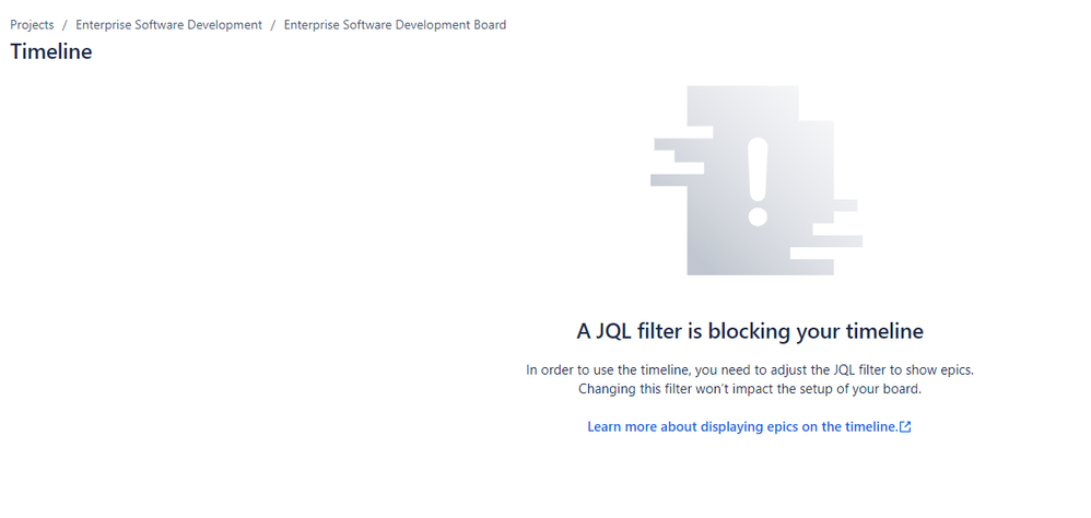

Didn't have this issue before, but logging on today I got the error that "A JQL Filter is blocking your timeline". Again, I haven't changed anything, never saw this error before, but now I do.
Any idea what I need to change in the filter? I am trying to show all epics except MWP-3756 so my query is:
project = MWP AND issuetype in standardIssueTypes() AND "Epic Link" not in (MWP-3756) ORDER BY Rank ASC
Any thoughts?

For the basic Timeline feature to work, your board filter must also include Epics from the same project. The basic Timeline feature will show only the Epics and the child issues of those same Epics that are within the scope of the board filter. If your board filter does not include any Epics, then the Timeline feature won't work. It can't be used to display only the child issues without their parent Epics.

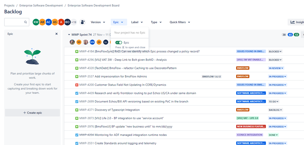

Tried the above filter and it did not work... Everything I want to show up on the board is. However the timeline feature gives that error and I can't filter the backlog by Epic because it says there aren't any. However I can filter the sprint by Epic... so they are there and associated with the project I believe... but seems I am missing something.

The Timeline feature requires that the Epics themselves be within the scope of the board filter. If there are Epics within the scope of the board filter, they can be displayed in the Epics panel in the Backlog screen. Your filter simply will not work for the Timeline because it does not actually pull any Epics into the scope of your board.

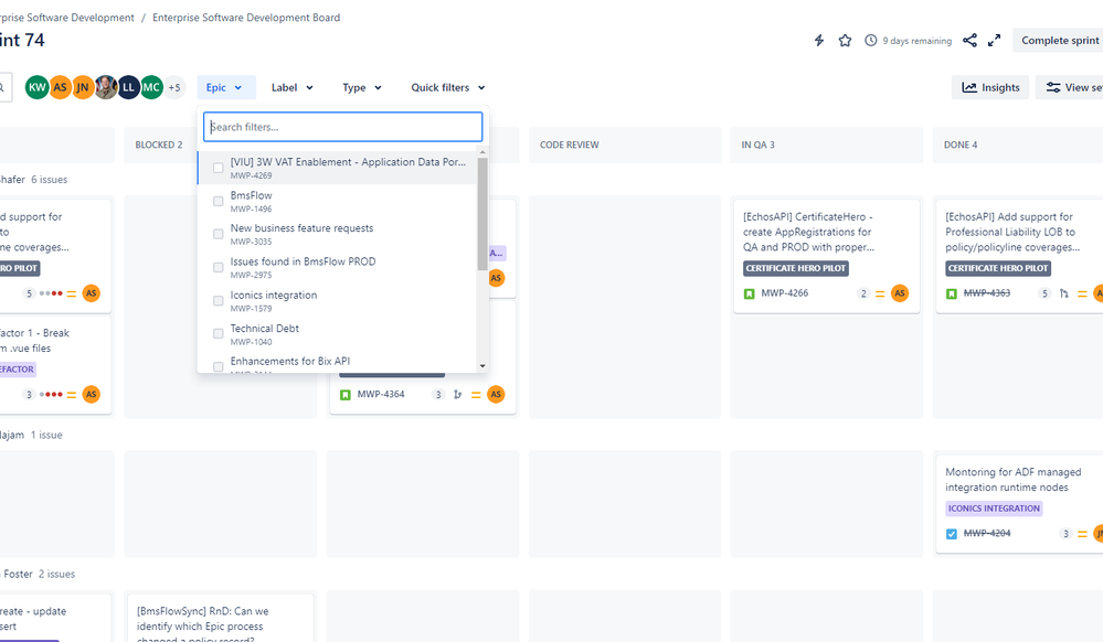

What exactly do you mean by "However I can filter the sprint by Epic"? Can you provide a screen image for that? If you are talking about the "quick" filter...
...that is created based on the actual values in the Epic Link/Parent field in the issues that are in the scope of your filter. It is not based on those Epics being within the scope of your filter. This list has no relationship to satisfying the requirement for the Timeline display.

See the attached picture... I can be in "active sprints" and see all the relevant tickets and sort based on the appropriate Epic. So it is the quick filet you are talking about. But if I understand your answer correct, those are not related? I'm having a hard time understand why these issues are part of the scope of the project but the Epics aren't?

1. Yes, the list of Epics in the quick filter on the Active Sprints board and the Epic requirement for the Timeline are unrelated features.
The reason Epics are not within the scope of your board is because of the filter you are using for your board.
project=MWP and issuetype in standardIssueTypes() and "Epic Link" not in (MWP-3756)
The first criteria tells Jira you only want issues from the MWP project.
The second criteria says you want to further constrain the results to only issues that are in the standard issue types. This specifically excludes Epic type issues and Sub-task type issues
