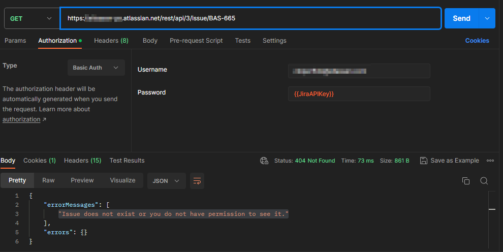

Hi all, I cannot get past this 404 error.
  • The account I'm using is the org admin.
  • I can view the data by entering the url into edge.
  • I've tried creating new api keys.
I am at a loss, please help.

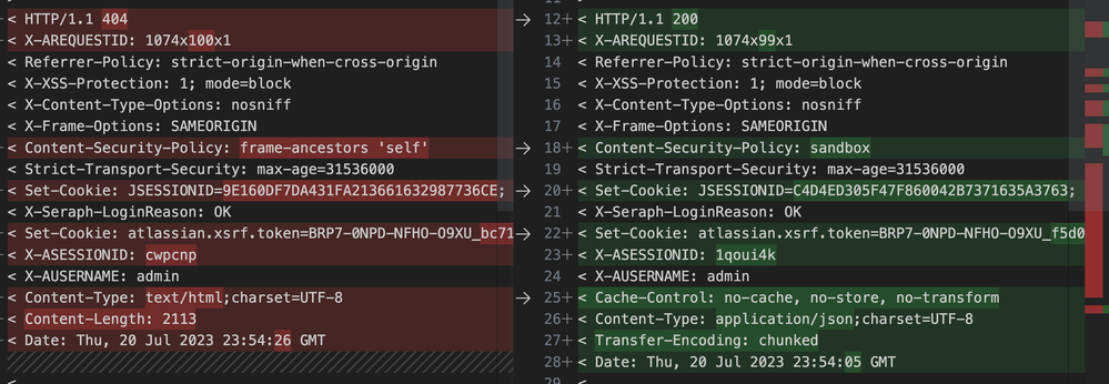

This is an interesting issue. I tried the following curl and was able to reproduce your results (the 404 error).
curl -v -u "user:pass" \
--url "http://localhost:8080/rest/api/3/issue/DEMO-1"
I then changed the API version to 2 and it worked as expected.
--url "http://localhost:8080/rest/api/2/issue/DEMO-1"
This is a bit curious as I have never come across this before. I checked the Atlassian documentation and both version 2 and 3 support the same authentication. According to the documentation, the difference in versions should not make any difference when it comes to authentication.
https://developer.atlassian.com/cloud/jira/platform/rest/v3/intro/#version
When I compare the verbose response from the curl, the only difference I see that sticks out is the "content security policy".
I tried this using a different Jira version (going from Jira 8.22.6 to 9.4.2) and neither version worked. However, I still see the "self" content security policy when the curl request does not work. I searched Google for "jira rest content security policy" and am seeing some interesting results. I believe this would be the place to start.
See this Atlassian documentation on Jira security headers. I believe this will resolve the issue.
https://confluence.atlassian.com/jirakb/security-headers-in-jira-939919914.html

Cameron Loperfido
July 21, 2023
Thank you so much for your response Hyrum! Unfortunately I am new to postman and API calls. I tried changing the get request to rest/api/2/, with no luck. I am using cloud so I cannot change the version of the Atlassian environment.
I'm not sure what you are asking here,
  • "Export the Postman content to curl and try the curl verbose flag."
But. I know what curl is and where to find the code snippet in postman, and what Atlassian recommends.

Cameron Loperfido
August 1, 2023
Turns out, I was trying to apply the org management API key from Atlassian Admin, not the one from my own Atlassian account. We got there, Hyrum! Thanks again for trying to help.
