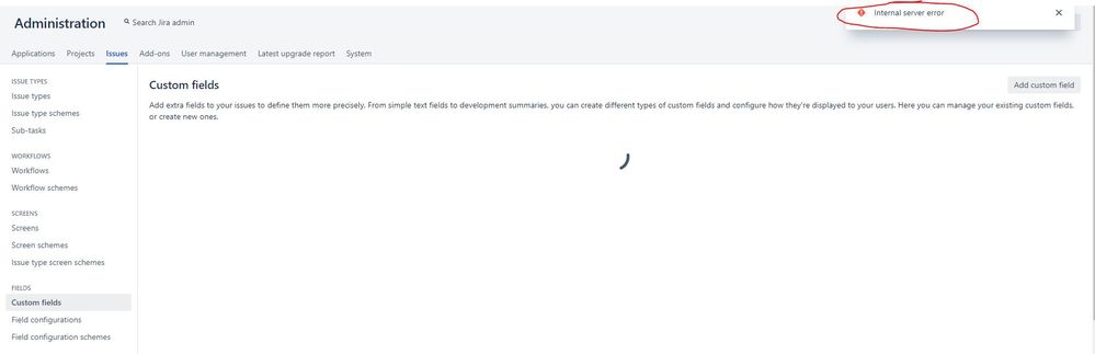

"Internal server error" when trying to browse Custom Fields
Sagi
February 21, 2019
When I try to access Custom Fields, I get an Internal server error (attached screenshot), and custom fields are not displayed.
This started after trying to add a new custom field.
Trying to figure this out for more than a week but with no luck so far.
Tried the resolution suggested on https://community.atlassian.com/t5/Jira-questions/Internal-server-error-when-open-Custom-Fields/qaq-p/936744 but the query failed.
Any ideas would be appreciated.

February 22, 2019
Sagi,
We'll need to know exactly what error is causing the problem on your instance, but I don't see that you included any logs.
Could you have a look at your Jira server logs and tell us what errors occur when you visit the Custom Fields page?
I'd also like to know what version of Jira you are using. Thank you!

Sagi
March 2, 2019
Yes, it's 2016.
The result for the query:
Everything beside the issue discussed is working, so I don't think it's a DB user issue, haven't touched it in years.
SMS
March 4, 2019
Sagi,
The fact that this query came back makes me think that the issue might have been that the proper database wasn't selected.
In the same console open that you used to run the validation query, can you try to run the fix query again?
Regards,
Shannon
Sagi
March 4, 2019
I ran both queries on the same query window (deleted and pasted the last query), so the proper database is selected.
SMS
March 4, 2019
Sagi,
I'm asking if you can run it again, immediately after the successful validation query. Could you confirm that you've run it again just now?
Shannon
Sagi
March 4, 2019
Yes, that’s what I did.
SMS
March 5, 2019
Sagi,
Thank you for confirming. We're going to need to look deeper at this than we'd be able to on Community, since I'm going to require your logs and support zip.
I've created a support ticket for you. Please take a look at your email now for that ticket number.
Once the issue is resolved, please feel free to come back here and let us know what the resolution was so it can help users in the future.
Regards,
Shannon
