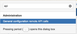

This is the Cloud bug JRACLOUD-45768 which states the same thing for Cloud.  With the way the development has been split for Cloud and Server it's possible that is still in/added back to Cloud for some reason, however, I'm unable to find that option in my 7.5 Server or my Cloud instance.
If I use "g+g" the option comes up but it doesn't exist on the page I was redirected to:
In addition, I checked with a Senior Cloud Engineer and the response was as follows:
The API in Cloud is permanently enabled and can't be toggled
This is also acknowledged by JRACLOUD-41876 - Adding a limit on REST API request:
Currently, there is no limit in sending REST API request. In some cases where users sending REST API request to run complex JQL queries with high frequency, it returns enormous number of results and it potentially causes an outage for the instance.
To prevent it to happen, it would be great if there is a limit on REST API requests.
I would check with the Cloud team if you can and see what could be going on with that instance because that shouldn't be a possibility at this point.  There are some add-ons that may need to have the API toggled so that may be a possibility as well.
If you feel comfortable providing your Cloud URL I can check to see what could possibly be going on.
