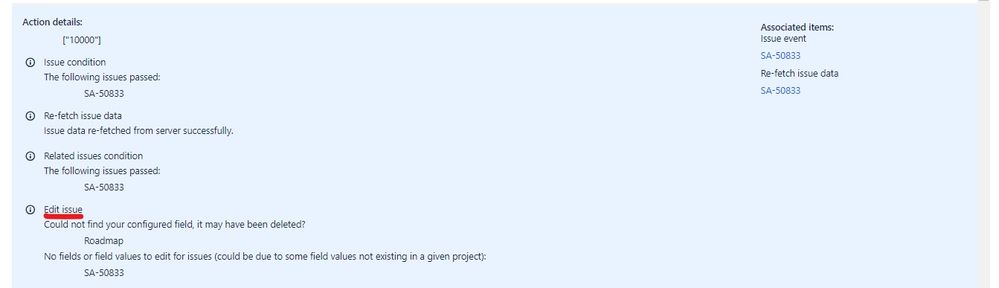

When I run it, I get the following errors:
Edit issue
Could not find your configured field, it may have been deleted?
Roadmap
No fields or field values to edit for issues (could be due to some field values not existing in a given project):
SA-50833

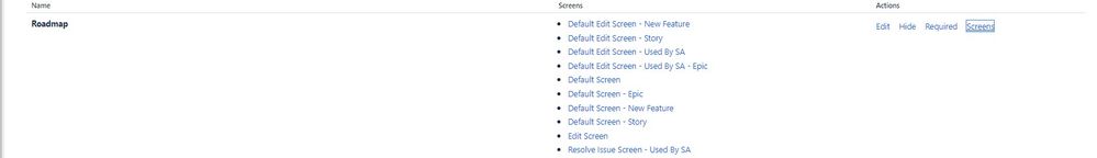

1. When you say the field is not selected for that issue type, are you referring to the field configuration for each issue type? if so, the field is there for all issuetypes I'm trying to copy to. If I'm missing something here, please let me know
2. Reg the issue views - if you are referring to screens, That's cover too. not the issue I guess

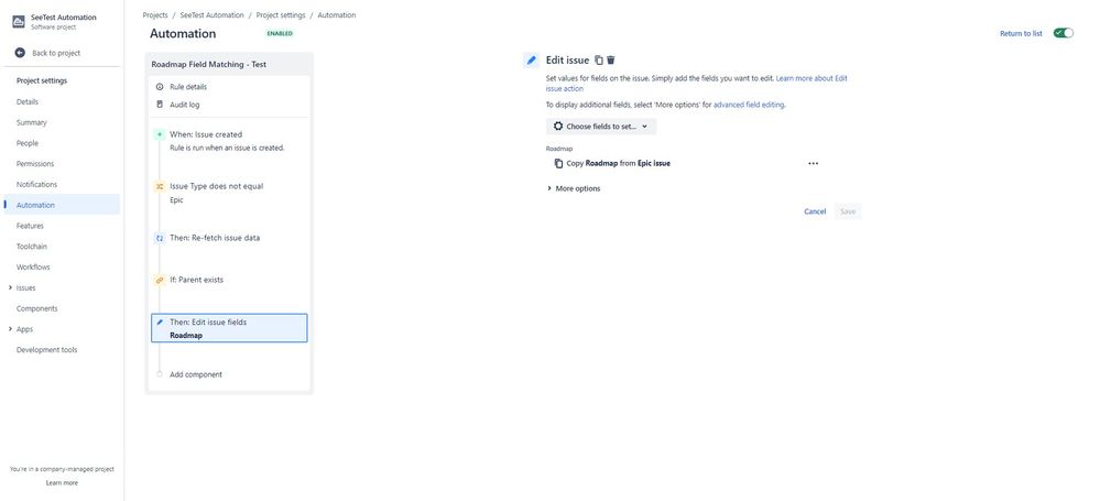

I noticed your rule image, and my first suggestion should have been: try adding a Re-fetch Issue action immediately after the trigger.
The Issue Created trigger can fire so quickly that the issue data is not yet available to the remainder of the rule (i.e., a race-track error).  This can cause unexpected behavior the remainder of the rule.  Always adding the Re-fetch Issue action with slow the rule by about a second, reloading the data before the steps proceed.
May Azulay
November 14, 2023

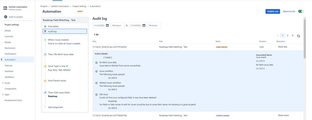

Hi @Bill Sheboy
Tried that too, is it possible it's related to the field functionalities?
Maybe I'm still missing something.
Adding screenshot:
Thanks
May
Bill Sheboy
November 14, 2023
I just noticed you posted an image of the edit, selecting the field from the drop-down list...and that this is a cascading, selection field.  That is not supported by automation rules yet, as described in this defect: https://jira.atlassian.com/browse/AUTO-258
The work-around is to use advanced edit with JSON rather than the drop-down list.  The defect describes the work-around, and here is some additional documentation on that technique:
https://support.atlassian.com/cloud-automation/docs/advanced-field-editing-using-json/#Cascading-select-custom-field
May Azulay
November 15, 2023
Hi @Bill Sheboy
Thank you, I assumed this is something to do with the field type.
I decided to change it to "single choice" and now it works perfectly fine.
Thanks again!

 Once check the field "Roadmap" is still present into the edit issue screen and  field configuration scheme for the respective issue types.
May Azulay
November 8, 2023
Hi @Wasim
Thanks for the quick response.
I verified it's present in both. Still getting this error...

May Azulay
November 7, 2023
Adding for reference the error and the automation structure
