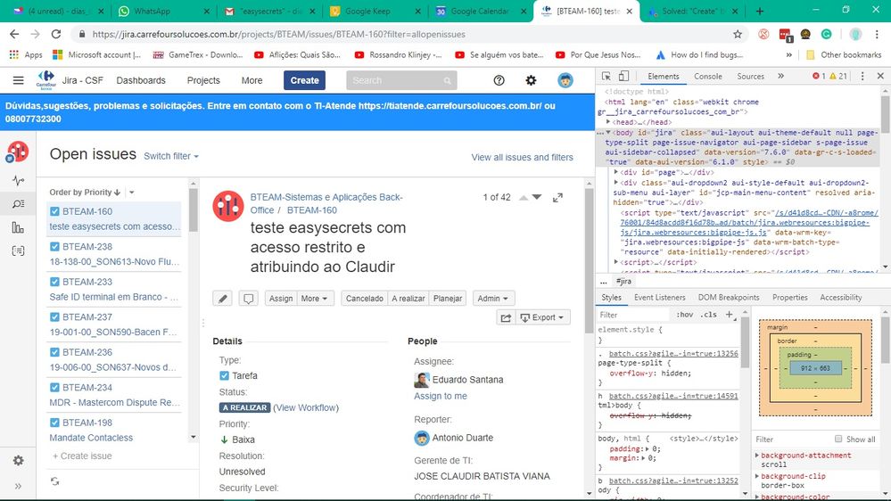

Hi, folks,
   I have the same problem. The pop-up screen is shown, I fill in its fields, but when I click on the Create button at the bottom, the problem is intermittent: sometimes the "Create" button works, sometimes, not.
   I make my tests always when JIRA is at exactly the same page (the initial page that shows the project issues when you open the project).Initial screen.jpg
   In our case, we DON'T have the nFeed app in our system.
   I'm able to activate de Developers Tool, but I don't have the expertise to analyze the info there.
   Please, can someone help with this? Which kind of info from the Developers Tool tabs must I send to you?
