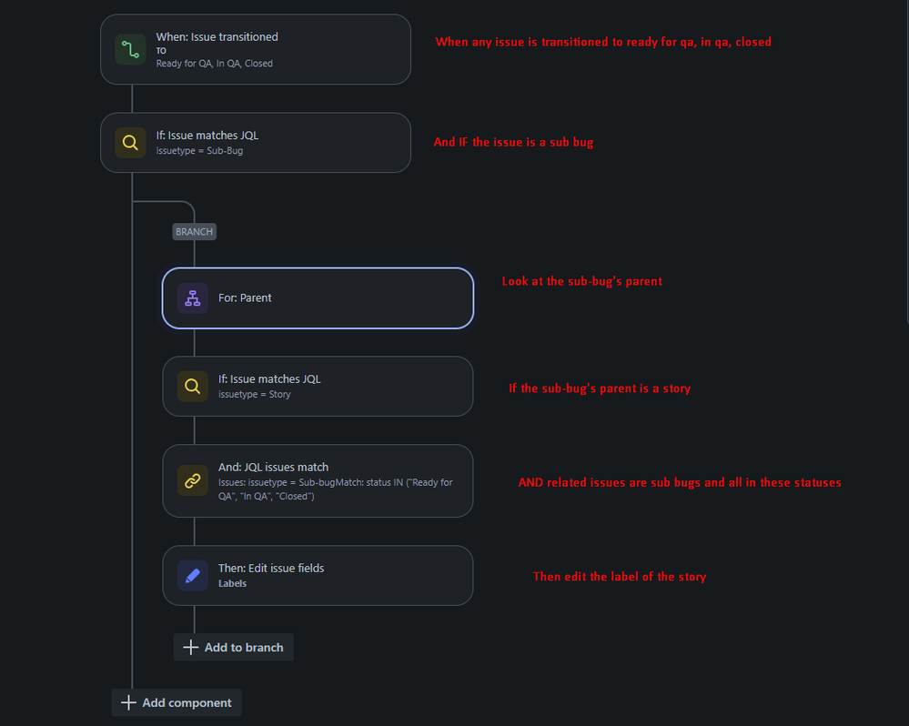

I have automation rules set up that add or remove a label based on the status of specific children of a story as follows:
  • When creating a sub-bug, add label "pending"
  • When when all sub-bugs are in "Ready for QA", "In QA", or "Closed", remove label "pending"
  • When reopening any of the sub bugs, add label "pending"
What no longer works is the rule that removes the label when all sub-bugs are in specific statuses.
This rule is supposed to look at only the sub-bugs linked to the story, and only if all of them are in specific statuses, it removes the label.
The rule, start to finish, does this:
  1. When any issue is transitioned to ready for qa, in qa, closed
  2. If the issue is a sub-bug
  3. Look at the parent
  4. If the parent is a story
  5. Look at the children of the story:
    - For all the sub-bug children
    - IF all are in ready for qa, in qa, closed
  6. Then edit value in field "label"
Here is a screenshot of the rule that no longer works:
This used to work fine, and to validate the logic of my rule - if I change to "Some match specified JQL" it can easily check that one of the sub bugs is in the right statuses and change the label.
What it can no longer check is that all the sub-bugs are in specific statuses.
The audit log simply says "The following issues did not match the condition" for the parent story.
In other words, even when all sub-bugs are in the right statuses, the rule says the story did not pass the JQL that checks that its sub bugs are in the right statuses.
Thanks in advance!
Dick

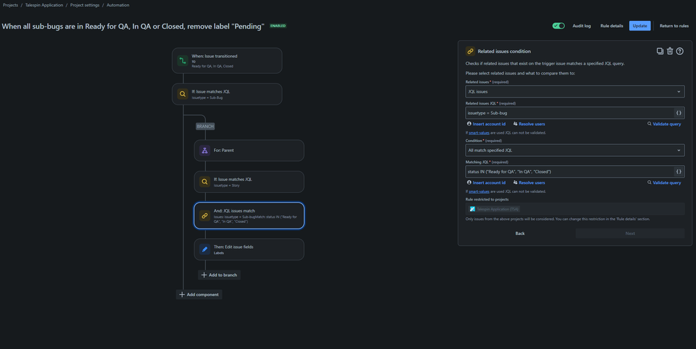

Hi Dick, thanks for your answer.
Indeed, once I step into "for parent", all components are related to the parent.
However, I am using the "related issues condition" which checks the related issues of the parent.
Furthermore, in the related issues condition, I restrict the check only to issuetype = sub-bug.
So it's ok that I am performing actions against the parent, because I want to look at the parent's related issues, specifically the issuetype = sub-bug related issues, which fit the status JQL - and based on that I want to remove the label on the parent ticket with the edit issue fields component.

September 2, 2024
Hi Andrei,
I've tested a similar query to yours. The linked issue statement highlighted in your picture is giving you ALL subbugs, since the first part doesn't restrict it to the parent issue you branched for.
The name "Linked" is deceitful here, it refers to the two statements inside the step. As you always end up with subbugs, the parent never gets the label removed.
Best modify the first part of this statement and include the parent using something like
parent = issuekey     <-- this is the Parent originating from your branche.
Hope this helps you along,
Sincerely,
Dick

The image i shared indeed doesn't mention anything about the parent, but this is because it is part of a FOR loop that selects the parent.
So anything done after FOR should be done to the issue selected by the FOR component.
This is how it worked previously as well.
I am also unable to use parent = issuekey, unless issuekey here is a smart value that can bring in the issuekey of the trigger issue.
Here is a step by step of what the logic is.
For: Parent should get me to perform actions on the parent - and the JQL issues match is specifically for related issues on the parent of the sub-bug that was created
Andrei Dediu
September 30, 2024
Hi @Dick
I made it work with your help! I found a smart value that tells me the parent of the trigger issue, so now I have "issuetype = Sub-bug AND parent = {{triggerIssue.parent.key}}" in the related issues component.
I think the issue here was the fact that i couldn't use "Sub tasks" in the related issues component, but rather "Matches JQL".
I couldn't use "sub tasks" because we use more sub task ticket types than just the sub bug.
In the related issues component, I am first selecting the issues with JQL, then comparing them to a second JQL so I can say "focus just on the sub-bugs".
However, it seems like this component doesn't ACTUALLY check for related issues. It's not implicit that the jql's will be run against whatever is related to the PARENT set with the FOR component.
Good learning points. Thanks again!
