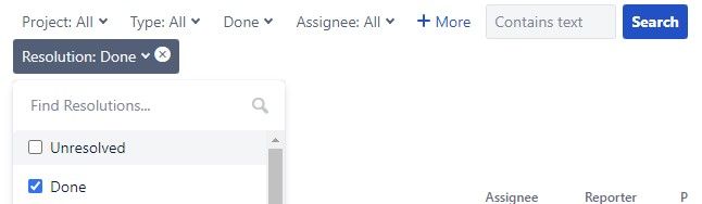

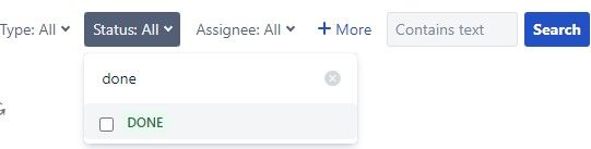

Brant Schroeder
April 29, 2022
@Amrita Welcome to the Atlassian community
You can create a filter that finds issues that are in the status of done or have been resolved as done.
