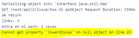

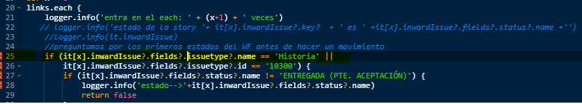

Buenos dias @Daniel Yelamos [Adaptavist] me salen problemas de propiedades cuando se que están completos y los campos no son NULL ya que hago una consulta desde consola y es todo ok, pero al incluirlo a la post.funtion... no funciona... es un cagarro (esto no lo traduzco)
Good morning Daniel I have still problems when they are complete since I make a query from console and it's all OK, but when I including it to the post.funtion ... it does not work ...
Eduard Diez
October 5, 2018
Sorry @Daniel Yelamos [Adaptavist] My problem is [x] I solved
Thank's for all
