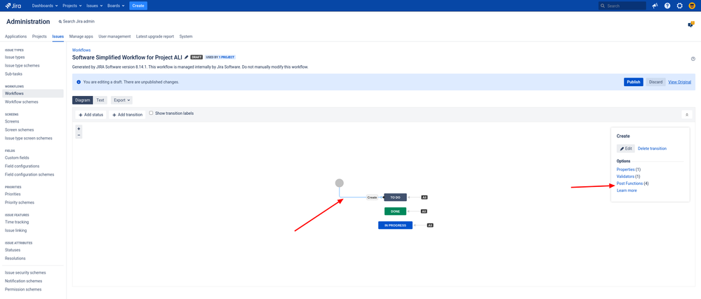

1) Go to the project's workflow. Switch to the Diagram view. Next, click on the Create transition and select the Post-Function link.

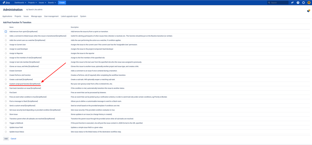

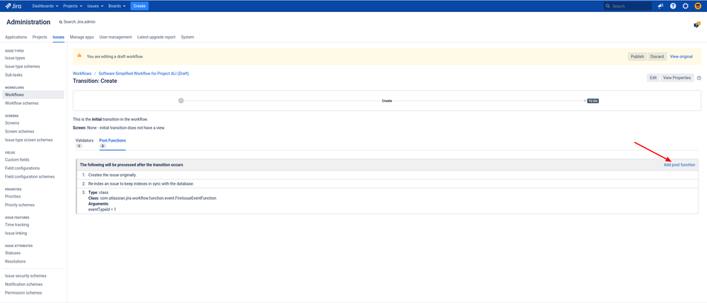

2) In the Post-Function config, click on the Add post function link.
3) Next select the Custom script post-function [ScriptRunner] option.

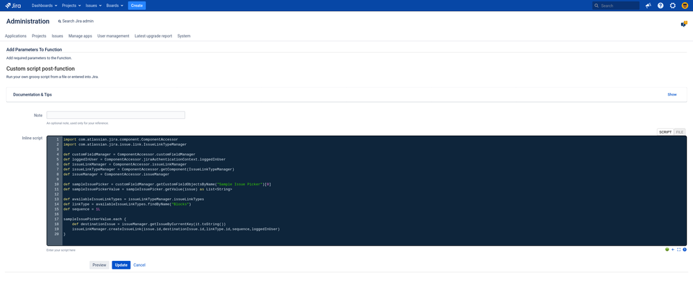

4) Once you are on the Custom script post-function page, you can add the sample code as shown in the print screen below.
Below is the sample code for your reference:-
import com.atlassian.jira.component.ComponentAccessor
import com.atlassian.jira.issue.link.IssueLinkTypeManager
def customFieldManager = ComponentAccessor.customFieldManager
def loggedInUser = ComponentAccessor.jiraAuthenticationContext.loggedInUser
def issueLinkManager = ComponentAccessor.issueLinkManager
def issueLinkTypeManager = ComponentAccessor.getComponent(IssueLinkTypeManager)
def issueManager = ComponentAccessor.issueManager
def sampleIssuePicker = customFieldManager.getCustomFieldObjectsByName("Sample Issue Picker")[0]
def sampleIssuePickerValue = sampleIssuePicker.getValue(issue) as List<String>
def availableIssueLinkTypes = issueLinkTypeManager.issueLinkTypes
def linkType = availableIssueLinkTypes.findByName("Blocks")
def sequence = 1L
sampleIssuePickerValue.each {
def destinationIssue = issueManager.getIssueByCurrentKey(it.toString())
issueLinkManager.createIssueLink(issue.id,destinationIssue.id,linkType.id,sequence,loggedInUser)
Please note this sample code is not 100% exact to your environment. Hence, you will need to make the required modifications.
After adding the code, click on the Update button.

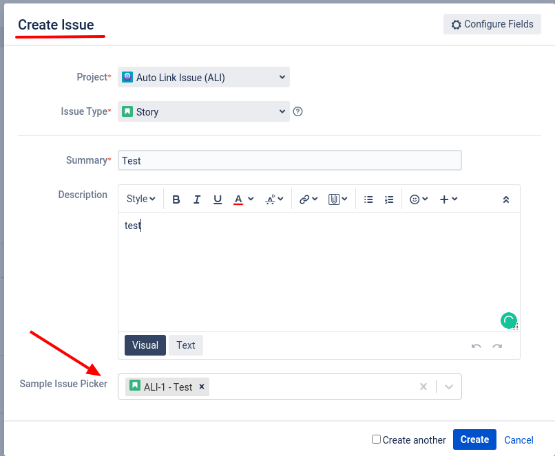

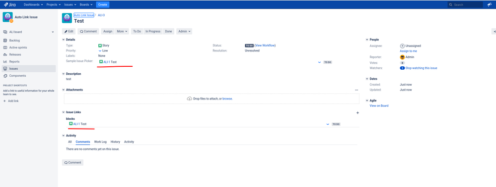

Now you can try to create an issue and select the issues from the Issue Picker  Once the ticket is created, you should see the linked issues as shown in the images below:-
