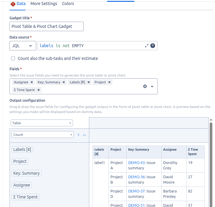

If you consider a solution based on a plugin, I think you can get such view by using the Pivot Table & Pivot Chart gadget offered by our Great Gadgets app.
Here is how:
  • Have a field of type Label that represents the request. Possible values could be Request-A, Request-A, etc...
  • Set this field to all 4 tasks of the request. So all the 4 tasks related to request X should have this label field set to Request-X. This way you link the 4 tasks related to request X together.
  • Configure the Pivot Table & Pivot Chart gadget like this:

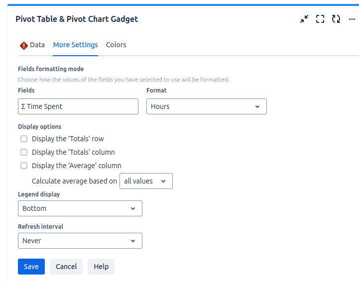

More settings tab:

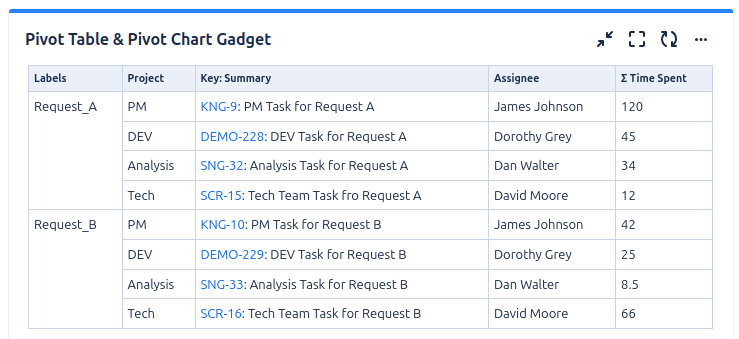

  • As a result, you will get a view like this:
My example does not display the time in status. But if you would add an automatically calculated field like "Age" which is the time since issue creation, you could add this to the pivot table. I think such field can be added with Script Runner. Or, you could use the Time in Status gadget that our app also offers.

Anca Cristescu
May 29, 2025
Thank you @Danut M _StonikByte_ :-)
I have tried both gadgets and Time in Status is the one that gives me a very nice overview on ALL tickets I need.
I did not consider initially the pivot table (my mind is not set to think in pivots :D), but I like this view also, for a very exact view on all tickets in the flow .
Now I need to make sure the users follow the procedures, so all tickets have the connection field. (spoiler alert... they will not)
