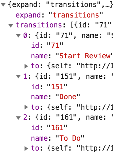

July 10, 2018
Thanks reply.
But, my jira server returned  json doesn't contains the "field" .
Kirubel Tesfaye
July 10, 2018
Could you show me your query Url?
like
https://localhost:8080/rest/api/2 + your query parameter
July 10, 2018
/rest/api/2/issue/11282/transitions
Kirubel Tesfaye
July 11, 2018
Hello again @雷,
Sorry for the late reply. I have seen your query parameter and what I observed is that you didn't use expand parameter.
You should append &expand=transitions.fields to your query parameter.
Hope this helps!
Like Markus Mitterauer likes this
July 13, 2018
Oh, I know it. Thanks.
