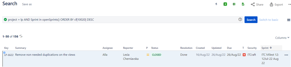

When I created a filter like this;
project = xx and Sprint in openSprints(), this filter shows the issues belong to an old sprint. These issues do not belong to another sprint. It is strange and cant find the reason.

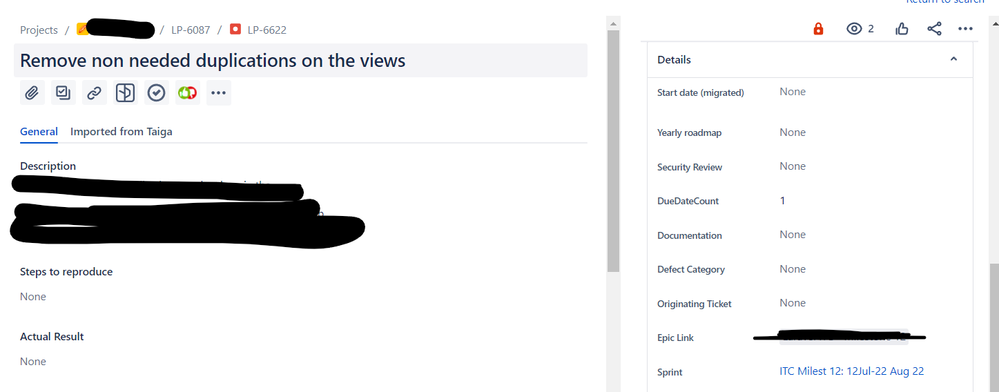

Aslihan Paksoy
October 11, 2023
Hi Trudy,

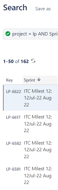

To confirm that the issue has truly every been in only one sprint, can you do a search for the issue, display the search results in List View, and include the Sprint column like this:
Aslihan Paksoy
October 12, 2023
Hi Trudy,
I can confirm these issues only belong to one sprint, here is the screenshotOldSprints.png

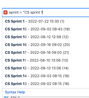

Can you do a search for "sprint =" that sprint's name and confirm there are not multiple sprints with the same name? When you start typing in the sprint name you should see a list of possible matches:

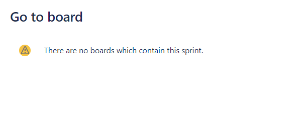

Trudy P Claspill
October 12, 2023
That suggests that the board where the sprint was created has been deleted.
