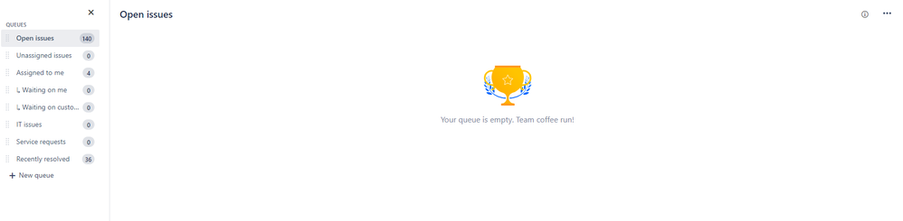

Hey there,
I'm using Jira Server and i have a service project called HR. in this project in open issues queue none of the issues are shown although there is 140 issues in this queue. the jql is simple resolution = Unresolved and the Queues part in left hand side it shows number 140 in front of open issues queue like the photo.
I have tried deleting the queue and create a new one its not working and all my other queues work properly and shows all issues.
I also have checked all the fields and they are ok.
with this jql i can see the issues in search for issue.
Has anyone had the same problem?

Hi @Negar Mousavi ,
I suspect this issue could be linked to the configuration of the queue or a potential problem with indexing.
  • Reindexing: Sometimes, discrepancies in issue visibility can be resolved by performing a full reindex of your Jira instance. This can be done through Jira administration by going to System >> Advanced >> Indexing >> Reindex.
  • Queue Configuration Check:
    Inspect the configuration of the "Open Issues" queue. Verify that the JQL filter for the queue is defined as resolution = Unresolved and ensure no other filters or conditions are limiting the display of the 140 issues.
    Double-check that the issue types and statuses considered in the queue's filter cover all the relevant issues you anticipate seeing.

Thanks for your answer
I have already did this things it didnt work then i tried testing different issue types in the filter of queue and when i exclude one of my issue types it worked can you guess why the problem is that specific issue type?
