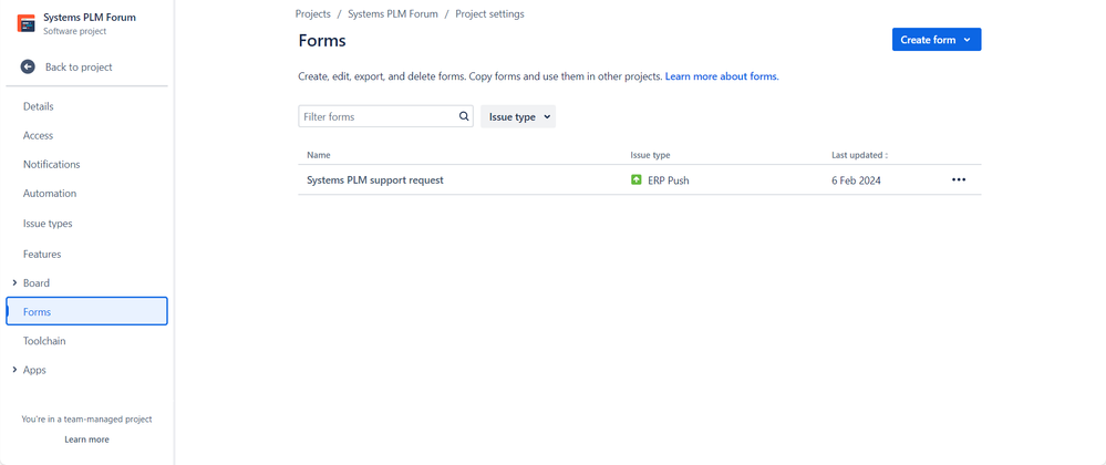

I created the form in project settings. I suppose there isn't a way to change the type of project from Software to Service Management?

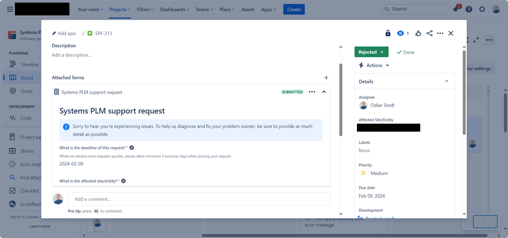

I guess I must be part of the Early Access Program, it's not a third party app:screenshot jira 2.pngscreenshot jira.png

It appears that Forms are available in JSW in a Premium subscription, as I do see the option there. Previously I was looking at an instance that was not on a Premium subscription.
