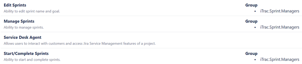

One of the Jira users is not able to edit/create a sprint on a Jira dashboard although the user belongs to a group that should have the right to manage the groups

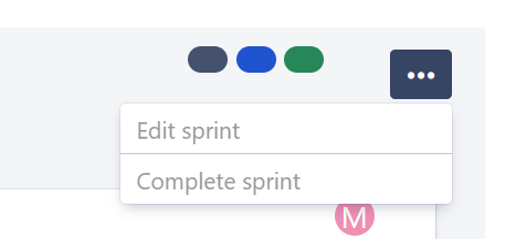

the buttons are disabled as you can see

ALso, I assume you have triple checked that the person in question is, in fact, part of the group shown in the screenshot?

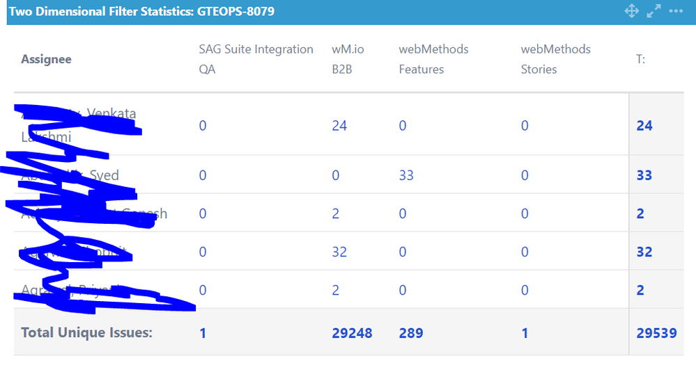

I have created a 2Dimensional gadget and I have checked all the projects and the  user has permissions for all the projects

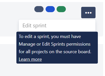

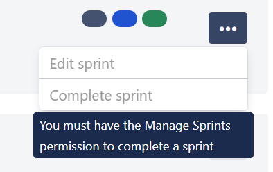

Additionally, I would also ask the user to hover with their mouse over the greyed out options, it should show a more detailed reason as to why the options are greyed out. Could you share that as well?

the manage sprints permission is available for all the projects of the dashboard and these are the messages the user gets when he hover over the buttons.

A realization I just had: the two-dimension filter results widget might actually not show all relevant projects! It depends on how the other filters this filter references are built up. Very likely there is something like "project in (A, B, C, D)" in that filter, causing your user needing to have this permission in all four projects, even if there isn't a issue matching the filter right now.
