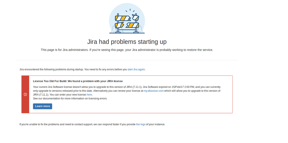

Hi I bought and install new jira instance without upgrade of expired licence which I used in the past. My sen:  SEN-12286520 .  Then I go to url /ConfirmNewInstallationWithOldLicense!default.jspa  I fulfill login/password and licence key for prefulfilled server id: B3O8-6IJ3-PRNA-J0ND,  but I get message with incorrect login or password. I put screen in the attachment.
marek maly
August 7, 2018
Hi find solution: I had installed(for testing purpose)  H2 DB, so new jira installation takes licence and other informations from that datasource. solution: remove all old data(in my case  in /var/atlassian/application-data/)
Nic Brough -Adaptavist-
August 7, 2018
So you gave it a new licence.
August 7, 2018
You can not use an expired licence for any version of Jira released after the end date of your licence.
You must renew the licence or buy a new one to use a version that was released after the expiry on the old licence.
