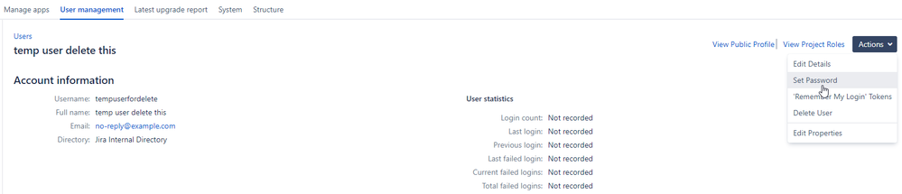

Radek Dostál
January 17, 2022
As long as the 'admin' user is in your local (jira) user directory, which it 99.9% is, then you can just "Administer" the user and change it's password directly in Jira UI without needing SQL:
