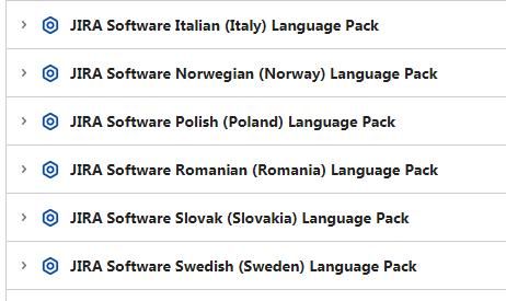

So, each time I do a JIRA update, multiple language packs are installed.  I uninstall them and then when I do the next update, they'll all back.  How do I resolved that?
JIRA Server 7.10.2

You may disable these language packs instead of uninstalling them.

So, I disabled the language packs, and this past weekend performed an update. Now my "Lasted Update report" reflects:
User add-ons disabled: 14
Some of your user add-ons have failed to start. They may not be compatible with this version of Jira.
We don't need the Chinese, Slovakian, Romanian, etc language packs, so why is JIRA complaining about them?
