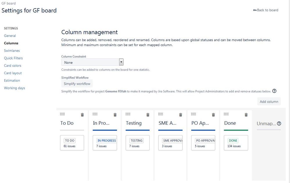

Alexey Matveev
June 28, 2018
Ok. Could you open the workflow for the issue, which you try to move, and see transitions which leads from the current status to the status, where you move the issue.

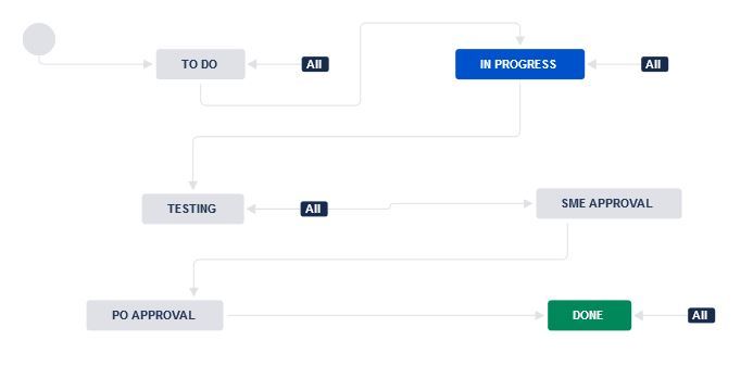

ok, so do I view the workflow as text or as diagram? Here is diagram view:
Nic Brough -Adaptavist-
June 28, 2018
You have to edit the workflow, then you'll get a button to swap between text and diagram.
Alexey Matveev
June 28, 2018
The problem is that you have two transitions for each status. Then one is a global transition (All) and the second one from one status to another. You need to delete redundant transitions.
Enter the Edit mode for the workflow and make changes. It does not matter if you do this changes in the text mode or in the diagram mode.
