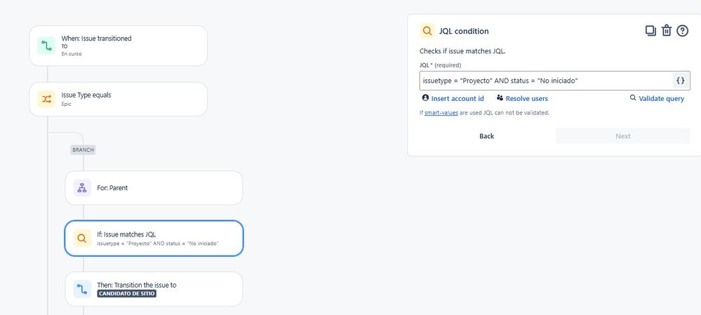

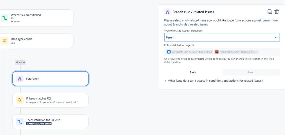

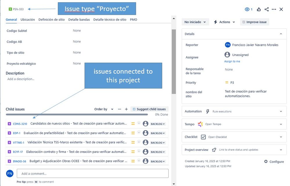

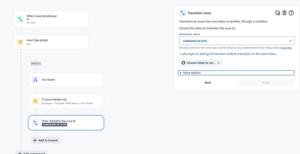

I'm trying to create an automation for a project in jira that moves my "Project" issue based on the movement of epics that live in different projects, these epics are connected with the "parent" field to the main project.
automation5.jpgautomation4.jpgautomation3.jpgautomation2.jpgautomation1.jpgI need the issue indicated in the parent to be moved to a particular state when the project epic goes to "in progress". I created the following but I don't know where I'm failing because my "project" issue doesn't move. Attached images.

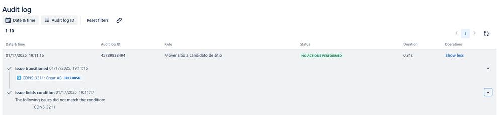

For an automation question, please also post an image of the audit log details showing the rule execution.  That will provide context to see which steps in the rule processed.
Also, what is the scope of your rule: single-project, multiple-project, or global?
You describe the issues are in different projects, and so the rule will likely need multiple-project scope.  Your Jira Site Admin will need to help make that change in the global automation area.
I first tried from the project that "triggered" the action to move the parent project from a "not started" state to a "site candidate", but in the "transition" action the final state (site candidate) did not appear, so I set the automation for "multiple projects", and in this scenario the final state I needed did appear.

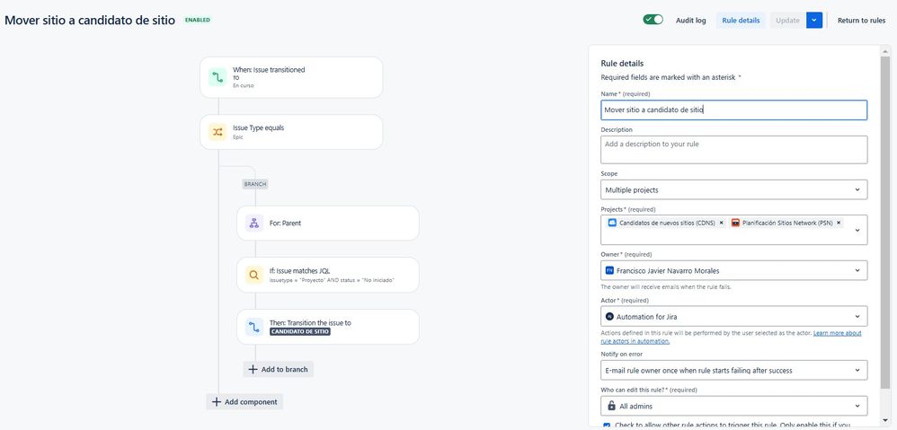

Trudy P Claspill
January 17, 2025
Hello @Francisco Navarro
Looking at the Audit log it indicates the rule was triggered by issue CDNS-3211, and that issue did not match the first condition (issue type = Epic) so the rule stopped running. Is that correct functionality? Is CDNS-3211 indeed not an Epic type of issue?
What happens if you transition an issue that is an Epic and has a parent issue in a different project?

The log says that CDNS-3211 failed the check to confirm it is an Epic. Is it an Epic?

You're right, it's not an epic you're seeing there, it's a subtask.
But it's because I have another automation that makes it so that when a subtask goes to "in progress", any of them, it moves the parent epic to "in progress".
This is done without problems, but I want that when that epic that was moved to in progress, it triggers another action towards the issue contained in the "parent" (The issue named "Project" that is in another project) and moves it from its "Not started" state to "Site candidate".

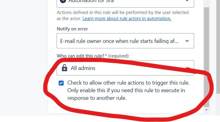

Trudy P Claspill
January 18, 2025
For this rule look at the Rule Details page.
At the bottom of that page is a check box that says something like Check this bos to allow this rule to be triggered by the actions of other rules. That box needs to be checked.
By default rule triggers are activated only when the trigger action has been executed directly by a user. In this case it is another rule that is transitioning the Epic issue.

Francisco Navarro
January 19, 2025
@Trudy P Claspill
That option you mention is already checked.
I really don't know where this could be failing, logically the conditions are fine but it doesn't do what I need. I tested "manually" moving the epic from the backlog to "in progress" but the automation didn't activate either.

What is shown on the Rule Details for the Scope of the rule?
Was the Project that contained that Epic within the Project Scope of the rule?
What information was added to the rule Audit Log when you manually moved the Epic in that case? Was the rule not triggered? Or was the rule actually triggered? If the rule was triggered then what messages are in the Audit Log for that run of the rule?

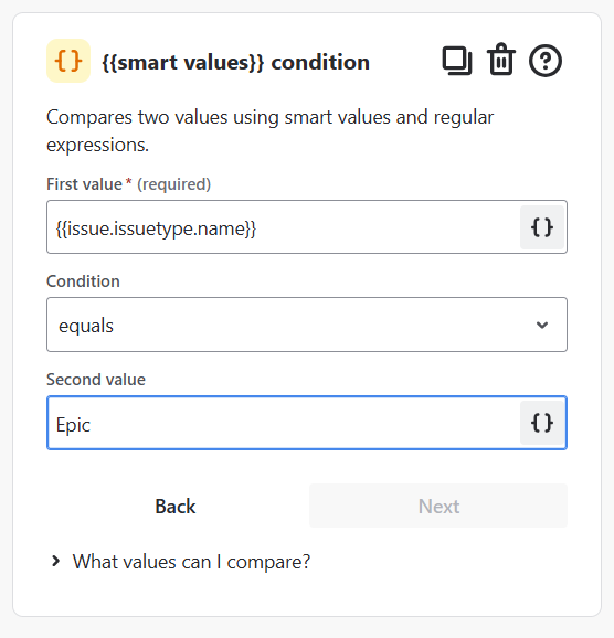

If the Epics might be in Team Managed projects then you will have to use a different type of Condition to check if the rule was triggered by an Epic issue. You'll have to use this:

1. The Issue Transitioned trigger allows you to specify only the starting and destination status. You cannot specify within the trigger the type of issues to which you want the trigger to apply. You have to add a Condition after the trigger to check the Issue Type of the trigger issue.
2. There is no need for a Condition to check the Parent link. The For Parent step determines if the Parent field of the trigger issue has any data. The Issue Type Hierarchy determines what type of issue can be the parent of another issue. If the hierarchy is configured to allow only "Project" issue types to be parent of an "Epic" issue, then this branch will execute only when the trigger issue (an Epic, per the previous condition) has a parent and that parent will be a "Project" issue.
3. Given that the Action to transition the issue is nested within the For Parent branch, that action will be applied to the Parent of the trigger issue - the parent "Project" of the "Epic".  Additionally that action has no direct configuration option for specifying the type of issue to which it should apply.

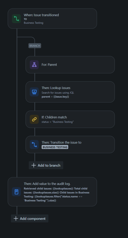

Jeffrey_Denton
January 19, 2025
Here is my automation for moving Epic (parent) based on Child Status.  My epic only transitions if all child tasks are in that status.  I have a automation per transition.  The first transition moves the epic, but every transition after that is based on if all children have the same transitioned status.
