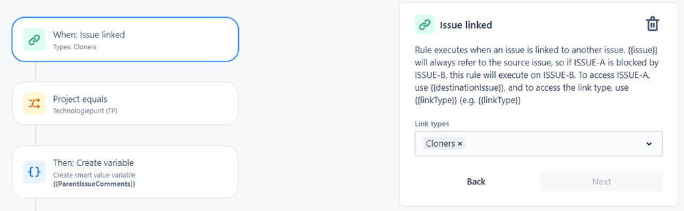

I have a trigger that starts on the cloning of an issue
When Issue linked (cloners)
the {{triggerIssue.key}} seems to be the master aswel as the {{Issue.key}}.
to paste a comment in the clone i need to get the most recently created issue from the branch I do assueme.
The Audit log provides me 2 issues for the trigger so if I can get these values in a var it would be possible to?
help is welcome.
Reading the audit log provided me the info:
you can also access it via {{destinationIssue}}):

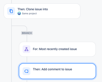

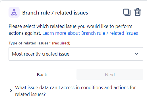

Hi @Steven Vits,
The easiest way to add actions to your most recently created issue would indeed be a setup like this:
Hope this helps!

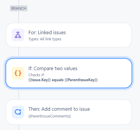

So thing is I'm trying to figure out how to copy the comments from master to clone in a global rule.
It seems to work but finetuning that only the latest clone will be provided with all the comments would be appropriate.
What I made was next:
the most recently created is giving next error:
