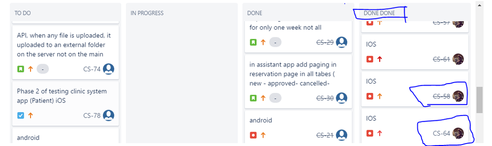

why in the same column "Done Done" there are a difference  in the action of two bug

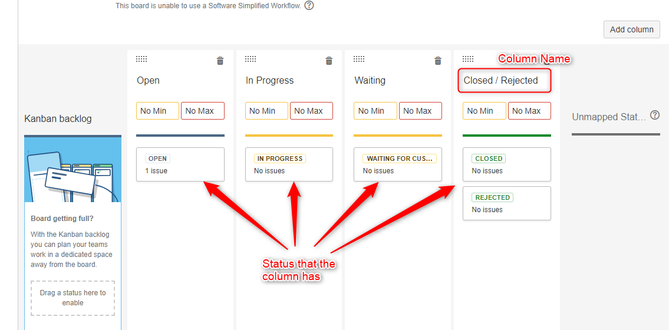

This is how a board can be configured:
So maybe in your board will be a column named "DONE DONE" and there could be some statuses.

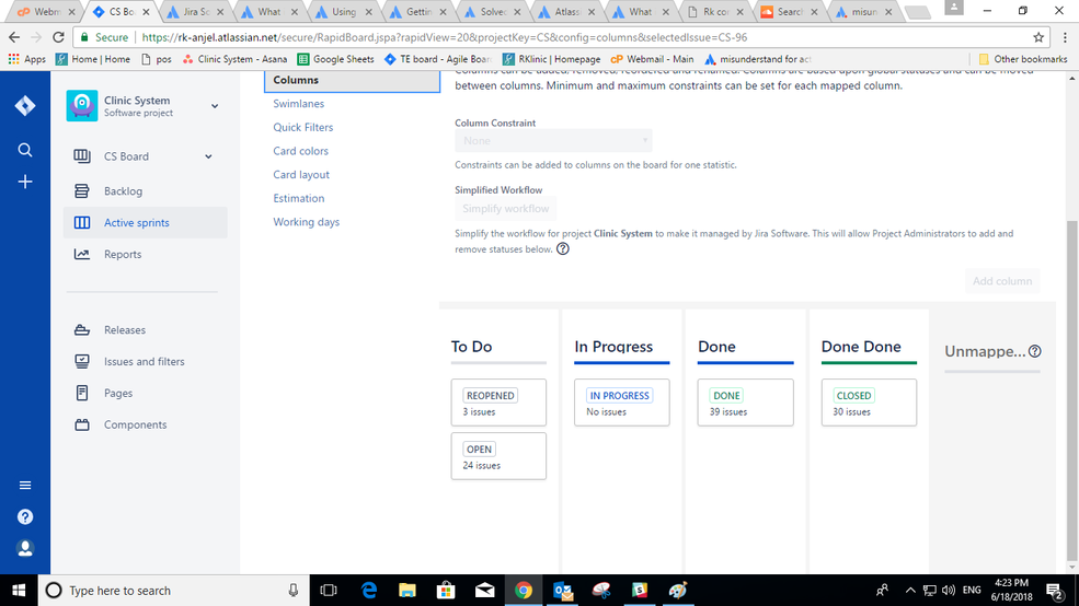

Gehad Hussein
June 18, 2018
this is the statues that are exists in the board .
Marcos Sanchez
June 18, 2018
Hi,
You should check your workflow then.
As I can see, you have a flow with something like "To Do -> In Progress -> Done -> Closed". So you can rename the column to "Closed", I think it's useless to have a "Done" and a "Done Done" if statuses are "Done" and "Closed" ...

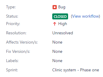

Also, refering to the "issue" that you talk about with CS-64, you could check at its resolution (because maybe it's unresolved) as @Jack Brickey said.

Jack Brickey
June 18, 2018
check the Resolution field of CS-64 I expect it is unresolved.

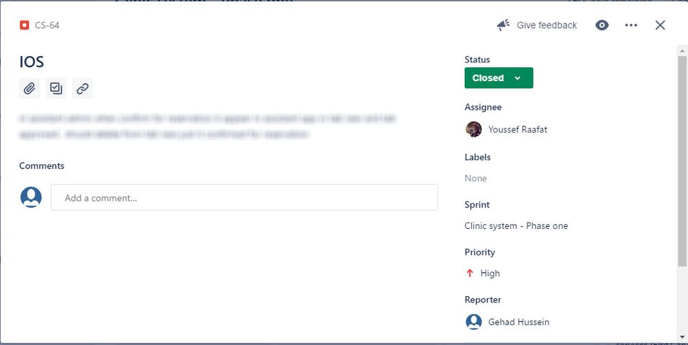

Gehad Hussein
June 18, 2018
how can i check the Resolution field , there isn't field with this name and the status is closed .
Jack Brickey
June 18, 2018
go into the View issue detail view. click on the CS-64
Gehad Hussein
June 18, 2018
yes, the resolution is unresolved in spite of the issues is closed
what will i do to solve this problem ??
Jack Brickey
June 18, 2018
There are two approaches:
  1. Add a Post Function to your WF(s) to set the resolution to Done
    1. edit each WF associated w/ the project (use diagram mode)
    2. double-click each transition into Closed
    3. open the Post Functions screen
    4. Add a post function to set the issue field and select Resolution and Done.
    5. publish the WF
  2. Force the user to specify the resolution value when closing.
    1. Create, if you don't currently have one, a screen that displays the Resolution field. Save the screen giving it a name e.g. "Resolution on Close".
    2. edit each WF associated w/ the project (use diagram mode)
    3. double-click each transition into Closed
    4. assign the "Resolution on Close" screen to the transition
    5. add a validate step require a resolution step
#1 is nice a clean and no one has to worry w/ setting the resolution but the downside is that ALL resolutions will = Done which isn't generally reality. #2 overcomes the downside of #1.
NOTE: in either case be sure if you have a 'reopen' transition that you add a post function to those transitions to clear the Resolution value.
