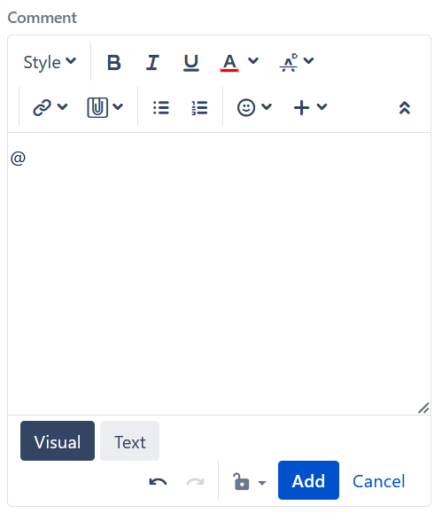

we're on Jira Software Datacenter 9.4.8.
We have got the phenomenon that the same person can mention users with @ within a comment for a Jira issue, but can't mention anyone within the comment for the same Jira issue, when the Jira issue is shown in the Issue Detail view.
This behaviour is repeatable for any Issue and any user who has the global permission "Browse users".

The problem appears when we click on an issue at an Jira agile board and the issues is shown at the right side of the board. What appears on the right side is called the "Issue Detail View" (for example in the Board configuration).
There we can add comments but can't mention someone with @ in the comment.
Nothing happens when we type an @.

We've found out that in our test environment we don't have the problem, though it is driven with the same Jira version, and that in our productive environment it only happens when we try it in "Visual" mode. In "Text" mode everything is fine.
