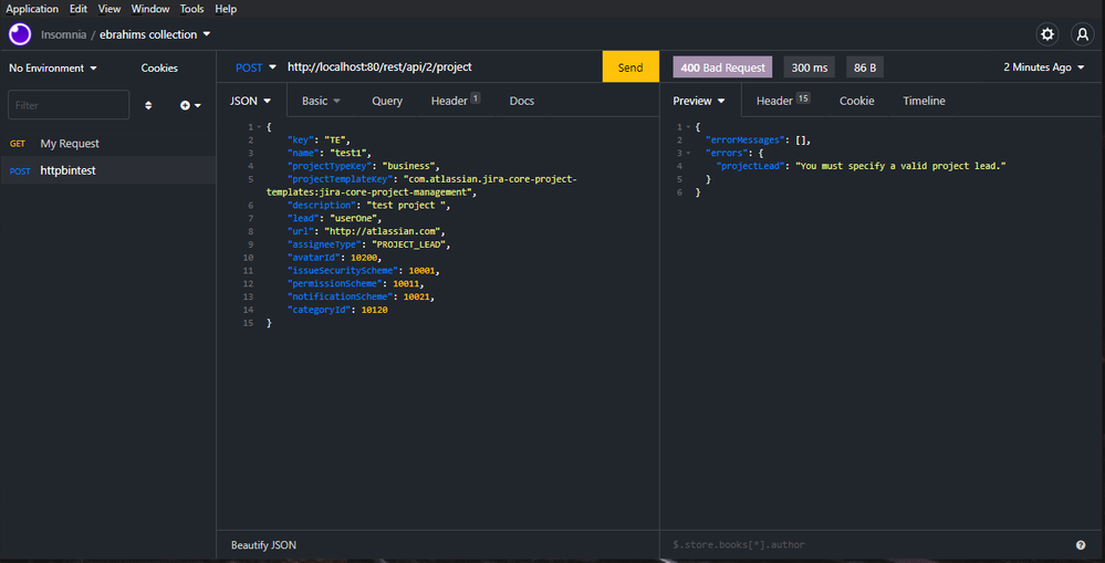

I am running Jira on docker. And making a simple rest API call to make a new project.
But I am getting an error "You must specify a valid project lead".
I AM indeed specifying a valid user called "userOne" that I have made on my server.
Can someone help me out what the problem is?
I have attached a picture of the POST request that I am making and the response that I am getting. doubt5.png

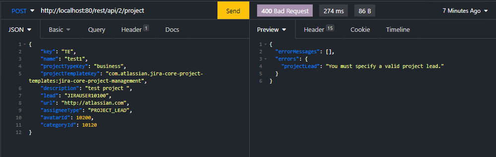

Hey. I tried your solution, and it unfortunately didnt work for me. I made a user that  had the ID which can be seen under "lead".
But i get the same error again.
