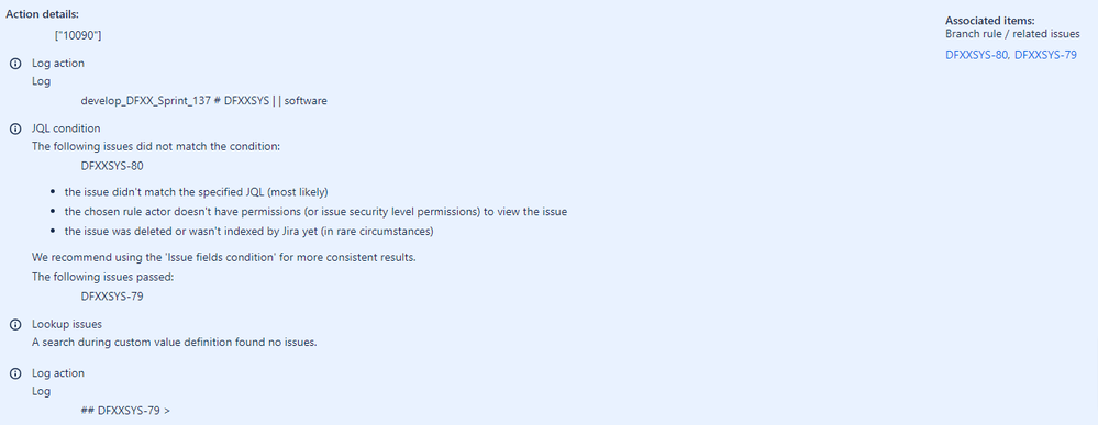

Hi @Trudy P Claspill , I get this:

Stepping through the Audit Log:
- According to the log there are two issues in the release and they are
DFXXSYS-80, DFXXSYS-79
- 80 doesn't match the condition that you set up inside the branch. Do you think it should have, or is that not a concern?
- 79 does match the condition, but the Lookup Issues action is returning no issues.
You've tried running the action's JQL directly in the search screen substituting in the actual issue key for 79 and that works, but validating the same explicit JQL within the rule is showing 0 issues.
I've got it! I was able to replicate your scenario.
Your JQL is looking for issues in another project. To actually be able to find the issues in the other project your rule has to have a Multiple Project Scope and name both projects as part of the scope.
When you create a single-project Scoped rule, the rule can only operate against and find issues in the single named project (with the exception of the Create and Clone Issues actions).
You need to access the rule from the Global Automations page, change it to a multiple project scope naming the DFXXSYS and UATBUG projects, and then your Lookup Issues action will work.
Note you may need to enhance your rule with additional conditions so that the it runs only against issues released from the DFXXSYS project, and so the Condition inside your branch includes checking that the issue in the release is from the DFXXSYS project.
