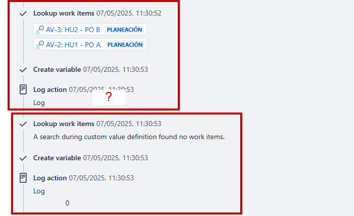

lookupIssues doesnt get data
Angel
May 7, 2025
Hi
We need validate in automation rule if a sprint has stories, so my rule activate by webhook so I search with this JQL "Sprint = {{webhook.id}} AND issuetye = storie" and then I create a variable with size but when I validate with audit log, it doesnt show anything, I´m dooing the same with the sprints and works,  What am I doing wrong?  We have Jira-Cloud

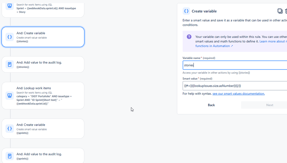

Hi @Angel
Without seeing your entire rule and audit log for context, I do notice two things:
The list size function used with a Lookup Issues result is already a number, and so converting that with the asNumber function likely does not work.  Instead please try just this:
{{lookupIssues.size}}
Next, you create a variable named stories but later write that to the audit log as {{strories}}.  Those do not match and so the audit log value will be null.  Please update the log write to {{stories}} and make the above change for using size, and then re-test your rule.

Angel
May 8, 2025
Hi @Bill Sheboy
"{{lookupIssues.size}}" didnt work neither, but I tried with "{{lookupIssues.size()}}" and its works
Thanks
