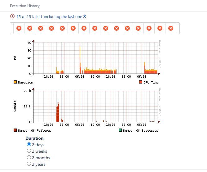

Philemon Nkafu
September 28, 2020
Hello Gustavo,
I ran to a problem with the script and I hope you may be able to help. The script is not returning a due date for "Medical Record Requested" value entered in the past. I basically want to have the field populate due dates for past tickets. Right now, it is only returning for values entered now.
Appreciate your help.

Philemon Nkafu
September 29, 2020
Hello Gustavo,
Am getting the following error message
Time (on server): Tue Sep 29 2020 11:58:12 GMT-0500 (Central Daylight Time)
The following log information was produced by this execution. Use statements like:log.info("...") to record logging information.
2020-09-29 11:58:12,576 ERROR [customfield.GroovyCustomField]: *************************************************************************************
2020-09-29 11:58:12,576 ERROR [customfield.GroovyCustomField]: Script field failed on issue: CSL-78632, field: Medical Record Due
java.lang.ArrayIndexOutOfBoundsException: -1
 at java_util_List$get$3.call(Unknown Source)
 at Script11.run(Script11.groovy:14)
Gustavo Félix
September 29, 2020
I guess the line 14 is
startDate.setTime(transitions.get(transitions.size()-1).created)
This is because when you create an issue , your transition size is 0.
That's why the -1.
So, do you need this to work when the issue is created?

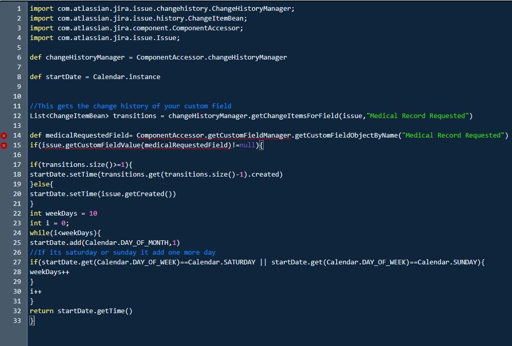

Philemon Nkafu
October 1, 2020
@Gustavo Félix This getting error on lines 14 & 15 columns 28 & 4 respectively i.e
Line 14 column 28
Gustavo Félix
October 1, 2020
Sorry, that was my mistake.
I cant copy from my jira instance  , so I missed the ()
def medicalRequestedField = ComponentAccessor.getCustomFieldManager().....
When those type of error appears, you can type ComponentAccessor , then ctrl space bar and it will show you the "options" you can type.

Philemon Nkafu
October 1, 2020
@Gustavo Félix I got the it working with no errors. A million Thanks for your help. Below is the final script.

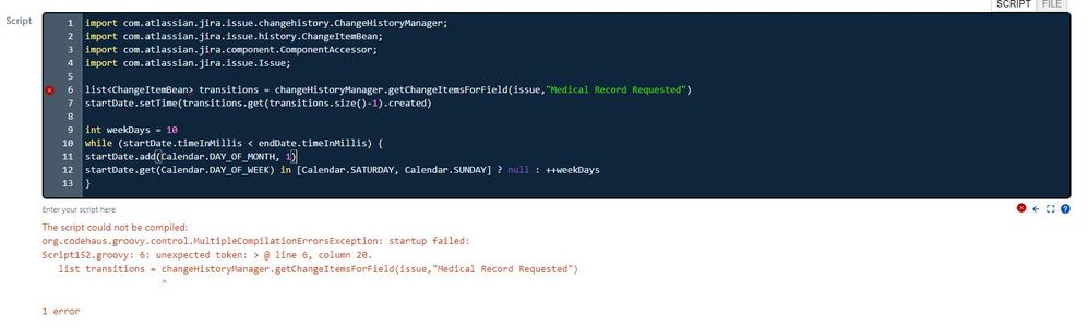

Gustavo Félix
September 23, 2020
Im almost sure is this line:
startDate.setTime(transition*.created.max())
Based on this:
https://community.atlassian.com/t5/Jira-questions/Not-able-to-get-last-custom-field-value-using/qaq-p/854451
I tried this and it returned the date:
List<ChangeItemBean> transitions = changeHistoryManager.getChangeItemsForField(issue,"your field name")
return transitions.get(transitions.size()-1).created
so, I guess this + your code could work
int weekDays = 10
while (startDate.timeInMillis < endDate.timeInMillis) {
startDate.add(Calendar.DAY_OF_MONTH, 1)
startDate.get(Calendar.DAY_OF_WEEK) in [Calendar.SATURDAY, Calendar.SUNDAY] ? null : ++weekDays
Let me know if it works.

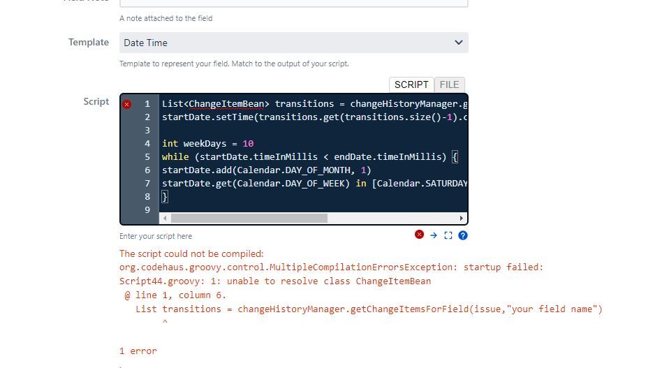

Philemon Nkafu
September 24, 2020
Scripted Field Error 9.24.2020.JPGI am getting the following error. I am creating a scripted field, could that be the issue? It seem you want me to do a post function instead.
Also, my requirement is not 10 days from issue creation date. It is from a Custom field (Medical Record Requested) that only gets completed at a different transition.
Gustavo Félix
September 24, 2020
Sorry , I forgot to add the import.
import com.atlassian.jira.issue.history.ChangeItemBean
I was also using a scripted field.
The 10 days that I add, was just to test the code, you can modify that part with your code.

Philemon Nkafu
September 24, 2020
Hi Gustavo,
Not sure what am not getting right but below is the exact script I wrote and still getting the above error
import com.atlassian.jira.issue.changehistory.ChangeHistoryManager;
import com.atlassian.jira.issue.history.ChangeItemBean;
import com.atlassian.jira.component.ComponentAccessor;
import com.atlassian.jira.issue.Issue;
list<ChangeItemBean> transitions = changeHistoryManager.getChangeItemsForField(issue,"Medical Record Requested")
int weekDays = 10
Gustavo Félix
September 24, 2020
Its because you have "list" instead of "List".
Philemon Nkafu
September 25, 2020
Hi Gustavo,
I have attempted to no success.
Gustavo Félix
September 25, 2020
Just saw that you dont have this
def changeHistoryManager = ComponentAccessor.changeHistoryManager
Philemon Nkafu
September 25, 2020
Where exactly should I fit this line? Can you please just provide me the completed script.
Thanks
Gustavo Félix
September 25, 2020
//This gets the change history of your custom field
List<ChangeItemBean> transitions = changeHistoryManager.getChangeItemsForField(issue,"Medical Record Requested")
def startDate = Calendar.instance
//Start date starts based on the last modification of your field
int weekDays = 10
int i = 0;
while(i<weekDays){
     startDate.add(Calendar.DAY_OF_MONTH,1)
     //If its saturday or sunday it add one more day
     if(startDate.get(Calendar.DAY_OF_WEEK)==Calendar.SATURDAY ||                                startDate.get(Calendar.DAY_OF_WEEK)==Calendar.SUNDAY){
        weekDays++
     i++
return startDate.getTime()
Let me know if this works for you
Philemon Nkafu
September 25, 2020
Thanks a million Gustavo. It worked

Philemon Nkafu
September 22, 2020
Hi Gustavo,
The log does not show any error.
