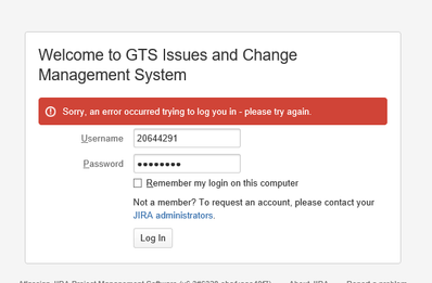

login attempts getting failed 2 or 3 times in jira

Yes, that warning happens when someone tries to log in with the wrong credentials.
Could you give us the warnings that happen in the application log when a user gets one of these login failures?  And the actual error they see?

With correct credentials also it is showing same, for sometimes it is successful login. below is the error details.
security  log details:
2018-11-29 00:20:41,127 ajp-bio-8009-exec-800 ERROR anonymous 20x1527539x1 1eejauc xxx.xx.xx.xx/rest/gadget/1.0/login [crowd.manager.application.ApplicationServiceGeneric] Directory 'New Crowd Server' is not functional during authentication of '52077652'. Skipped.
2018-11-29 00:20:41,127 ajp-bio-8009-exec-800 ERROR anonymous 20x1527539x1 1eejauc xxx.xx.xxx.xx /rest/gadget/1.0/login [jira.security.login.JiraSeraphAuthenticator] Error occurred while trying to authenticate user '52077652'.
That's the problem - it can't reach your Crowd server.
