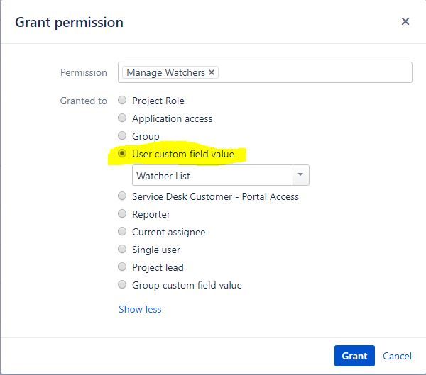

Make a custom field of type "user picker" that is called "Users who can Manage Watchers"

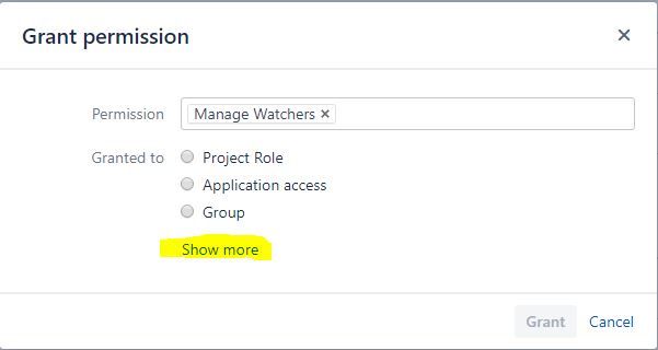

In your permission scheme, set the Grant the "Manage Watchers" permission to the "User Custom Field Value" to "Users who can Manage Watchers"
(You may need to hit "show more" in the grant permission window to see it.
Then in the postfunction of your create transition, set the list of users in the "Users who can Manage Watchers" custom field to the list of users who can edit.
Jenny Chen
February 11, 2020
Hi Andrew, Thanks a lot, it works! Jenny
