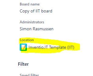

It's still there in our instance via:
  1. Board Settings > General
  2. Location is between "Administrators" and "Filter"

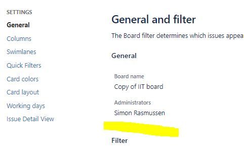

@Ste Wright I used to see the location same place as you describe.

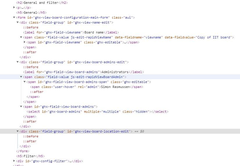

I can see in the code on the board setting there is a div container for location but it is empty.
As you can see in screenshot from board the location is missing. this is the same on all our boards.

If I create a new board I can choose location, when I see the list of kanban boards I can also see location. so I am puzzeled as to why is is not possible to edit on existing kanban boards.

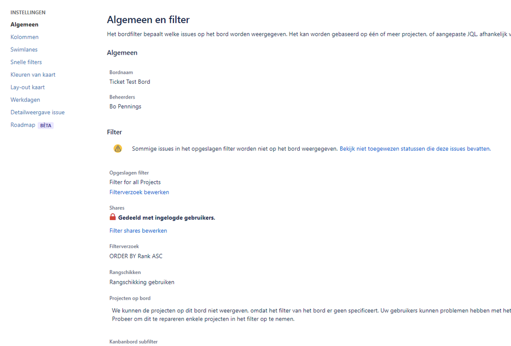

We have the same problem. After copying a bord the location is gone. We only use Classic projects.
I used the work-around to solve the problem for now.
Here is a screenshot:
