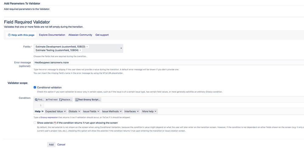

help me please with validation on workflow (create issues)
jmwe conditions
required fileds value must be not empty and !=0
issue.get("customfield_10803")!=0 && issue.get("customfield_10804")!=0
this one should works but it`s not

are these Number custom fields? And are you using this script in a "Scripted (Groovy) Validator"?
You need to create a Scripted (Groovy) Validator, not a Field Required Validator. Conditional Validation will simply skip validation if the script returns false.
Then the script of the Scripted (Groovy) Validator should be:
issue.get("customfield_10803") && issue.get("customfield_10803") !=0 && issue.get("customfield_10804") && issue.get("customfield_10804") !=0
yes, thanks! I used two validators. required and Scripted (Groovy) Validator,

First your fields has to be number field, if it's not the case and theyr are text fields, you have to cast them into double or integer.
Also I think you should check if a value exist for your field before.
So can you try something like
( issue.get("customfield_10803") && issue.get("customfield_10803") !=0 ) &&
( issue.get("customfield_10804") && issue.get("customfield_10804") !=0 )
Because it my interpret null != 0 as true.
Regards
yes, for sure there`re number fields.
it`s not working as well
