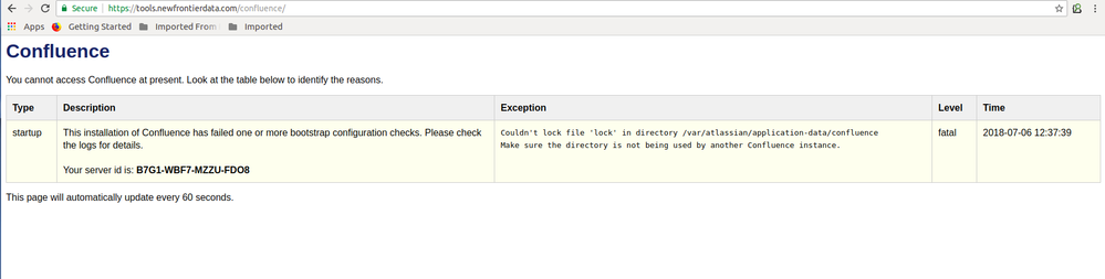

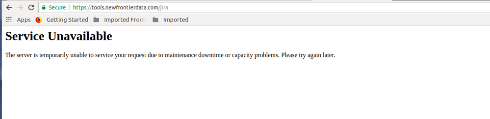

we have local host 2 jira project on /opt/atlassian/jira and /opt/atlassian/jira2 with custom port port for jira2 and custom home directory for jira2 as well . at the moment jira1 projet version is JIRA v7.7.1 and Jira2 project is  JIRA v7.9.2 i need to update both projects jira version to latest stable version 7.10.2 . I have conducted following steps to update both jira project  but unfortunately got some issues. Appreciate  your support this regards.

The first message you show us tells us that Jira is not running.  You should check whether it is running, and read the logs to see what is wrong with it.
Your second message is about Confluence, not Jira.
