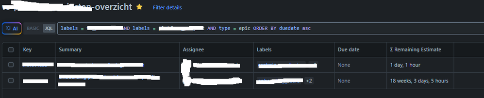

I have a saved filter, which shows the correct remaining estimate: jira-epic-filter.png

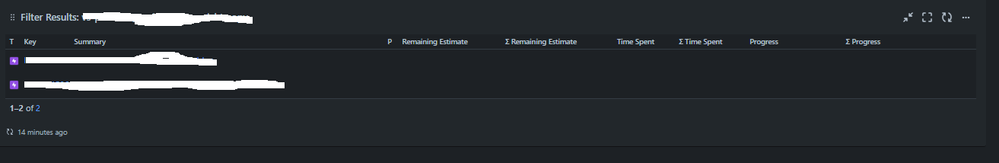

But when i use this filter in a dashboard in the same project, using the 'filter results' gadget any time-tracking fields are empty:

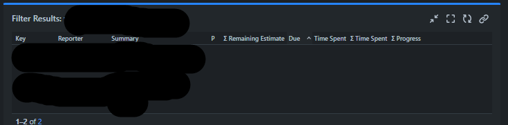

so i have one saved filter, named 'my_saved_filter' showing 2 epics wíth correct remaining estimate calculation.
When i use 'my_saved_filter' in the project's dashboard using a gadget named filter results the remaining estimate field is empty...???:
I am owner of the dashboard. In the dashboards many other properties of the epic are shown as expected, like assignee, due date, reporter etc...

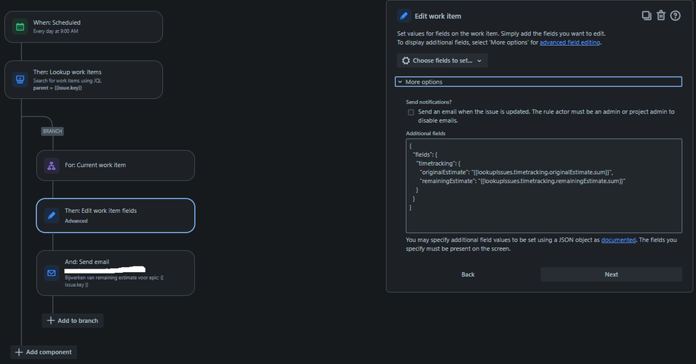

This is the daily scheduled task to update the remaining estimate in jira:

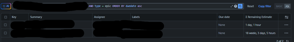

This is the result in the filter itself:
It clearly shows the data expected, so that's OK.
But not i use this same filter in a dashboard using filter results gadget and the data is not shown:
So there is something wrong with the filter-results gadget or somehow i need to check some specific settings?
