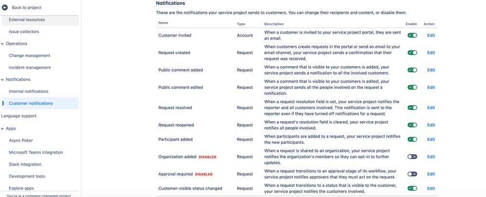

Can you share the Customer Notification setting of the project?

May 11, 2025
Barry Hueston
May 11, 2025
Thanks @Piyush Annadate _ACE Pune_ config listed above.
