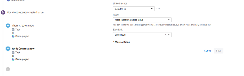

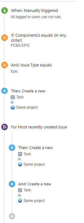

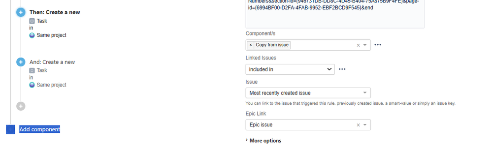

I have a manual automation
I create an EPIC: TEST123
then run my manual automation, this then should create 3 tasks
Then: create a new: TASK "Task 1 Create your project"
For most recently created issue
    then create a new: TASK "Task 2 create your part numbers"
    and: create a new: TASK "Task 3 create your bill of materials"
This works. I now want my tasks to be linked.
    Task 2 create your part numbers (LINK TO TASK 1)
    Task 3 create your bill of materials (LINK TO TASK 1)
This is where the problem occurs. Instead I get:
        Task 3 create your bill of materials (LINK TO TASK 2)
Even though Task 3 is still under the "For most recently created issue" it should create a link to TASK 1. I cannot get it to work

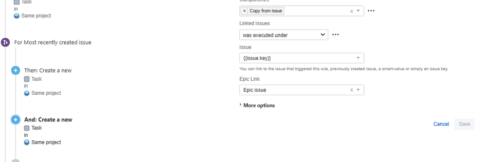

I only have these 2 options for what my issue is linking to:

Thanks for that information; I am using Jira Cloud rather than Data Center and see something differently for that action.
Let's try this:
  • in that field, type in {{issue.key}} rather than using the dropdown list
  • when that expression appears below the field, select it for use
  • test your rule to see if it links correctly

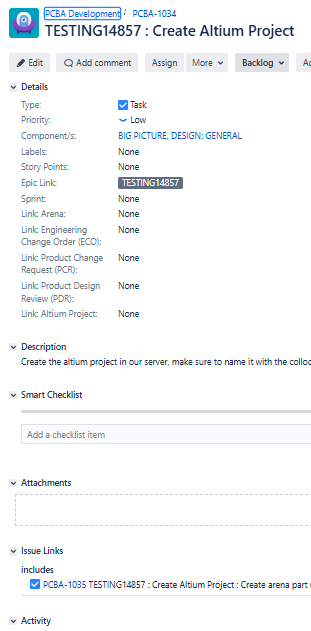

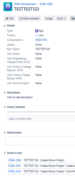

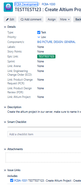

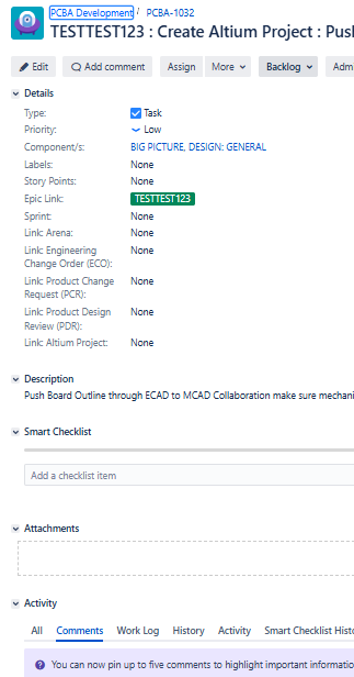

thank you again for the details. ok tried the {{issue.key}} but now TASK 3 has no linked issues

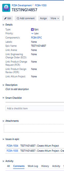

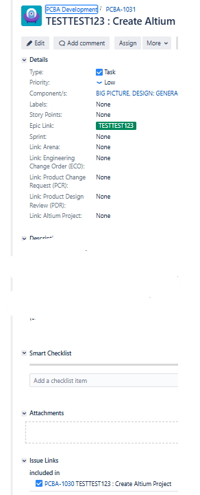

EPIC:
TASK1 (with correct link to TASK 2):
TASK 2 (correctly shows backward link to TASK 1):
TASK 3 (INCORRECTLY HAS NO LINKS):

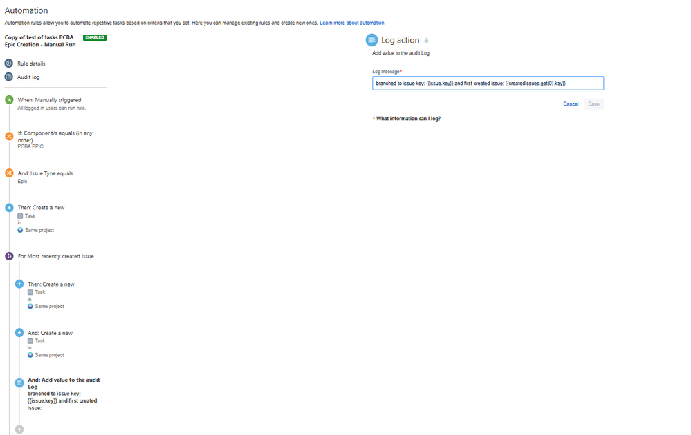

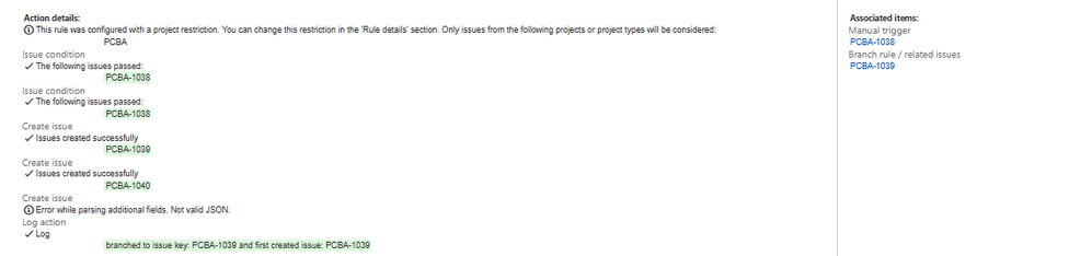

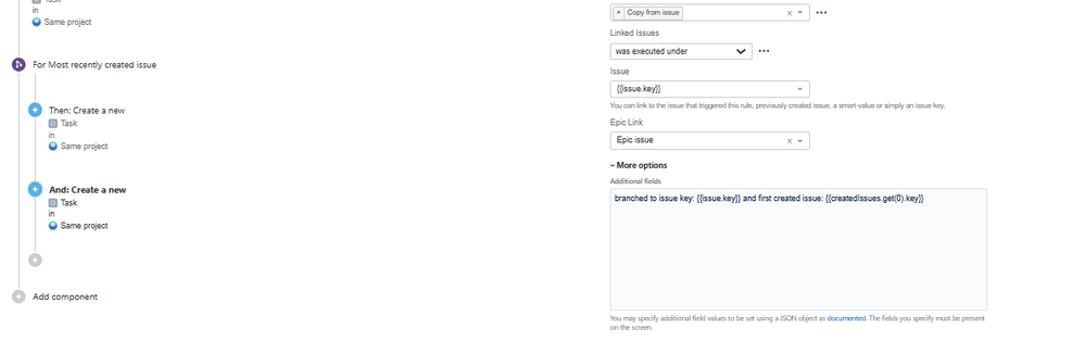

Please add a write to the audit log inside the branch with the following to check what the value is, then re-test to see if the issue is present:
branched to issue key: {{issue.key}} and first created issue: {{createdIssues.get(0).key}}
julia
December 5, 2024
definitely weird!
i must have some syntax messed up somewhere

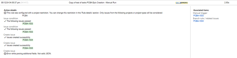

AUTOMATION:
AUDIT LOG:audit log.png

Please remove that text from the "more options...additional fields" fields area and instead add a Log Action to write that text to the audit log:
https://confluence.atlassian.com/automation/jira-automation-actions-993924834.html#Jiraautomationactions-logactionLogaction
julia
December 9, 2024
opps sorry! here is the log action. LOG ACTION.pngAUDIT LOG WITH NEW MESSAGE.png
Bill Sheboy
December 9, 2024
Thanks!  That indicates either value should have worked for the linking.

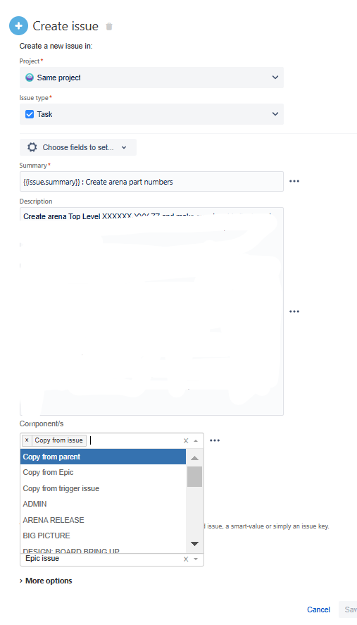

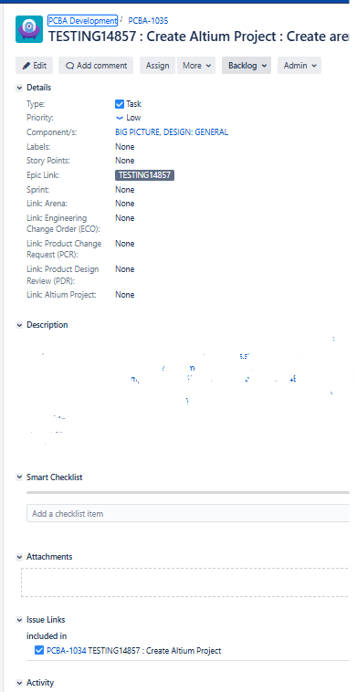

note that for issues 2 and 3, I also have components: copy from issues: copy from parent. will this setup with no branch affect this? create issue component copy from issue.png

Good day! Thank you very much for the help. The linked issue piece is working! Some additional questions:
1. Does this mean that I need to remove all branching?
2. I have a list of about 15 tasks that my complete automation runs, does this mean I need to keep track of the index for each one that I want to link to and adjust the {{createdIssues.get(X).key}} where is the index of the task I want to link to.
3. Do I need to refetch issues?
Also, this did break the component inheritance.
WHAT I NEED:
  • EPIC COMPONENT: PCB EPIC
  •     TASK 1 COMPONENTS: BLAH1, BLAH2
    • TASK 2 COMPONENTS: BLAH1, BLAH2
    • TASK 3 COMPONENTS: BLAH1, BLAH2
WHAT I GET:
    • TASK 2 COMPONENTS: BLANK
    • TASK 3 COMPONENTS: BLANK
