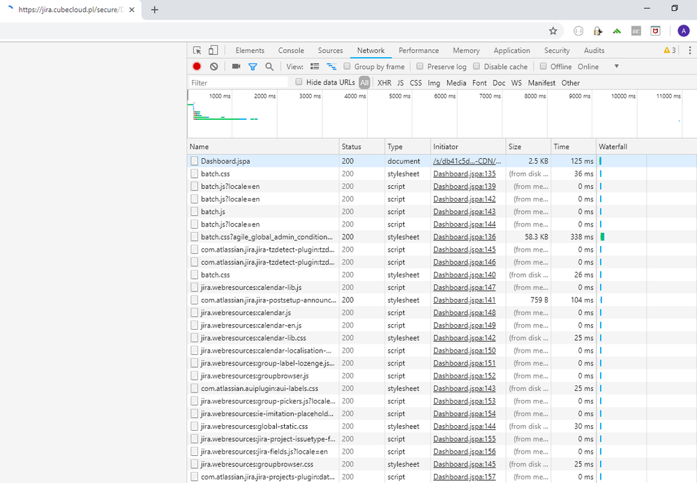

yes, all request are pointing right, eg:
https://jira.cubecloud.pl/rest/api/1.0/shortcuts/74002/995cd2eaa79e6543b58f399fb66e5383/shortcuts.js

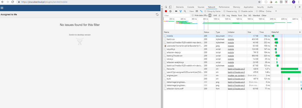

After login (but browser is still waiting):
other than dashboard url:
I can provide login and password (with same safe way) to my Jira - this is fresh installation with nothing inside.

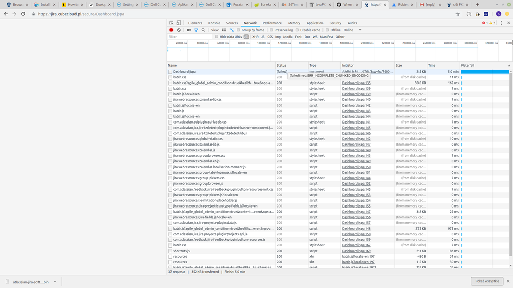

So the browser is actually still waiting for something when you get the blank page? Have you tried waiting until it times out? Does that give a line with an error code in the network monitor?
Have you tried another browser / completely clearing the cache for the domain?
I see that you are using Jira 7.4.0, any specific reason for the old version and not the latest?
Adrian Lapierre-Mróz
December 6, 2018
after some time browser stop loading and I got net::ERR_INCOMPLETE_CHUNKED_ENCODING::Zrzut ekranu z 2018-12-06 12-32-57.png
I try'ed from other browser on different computer - the same.
There is no reason to use  7.4.0 - i can upgrade it to latest if it can help.
