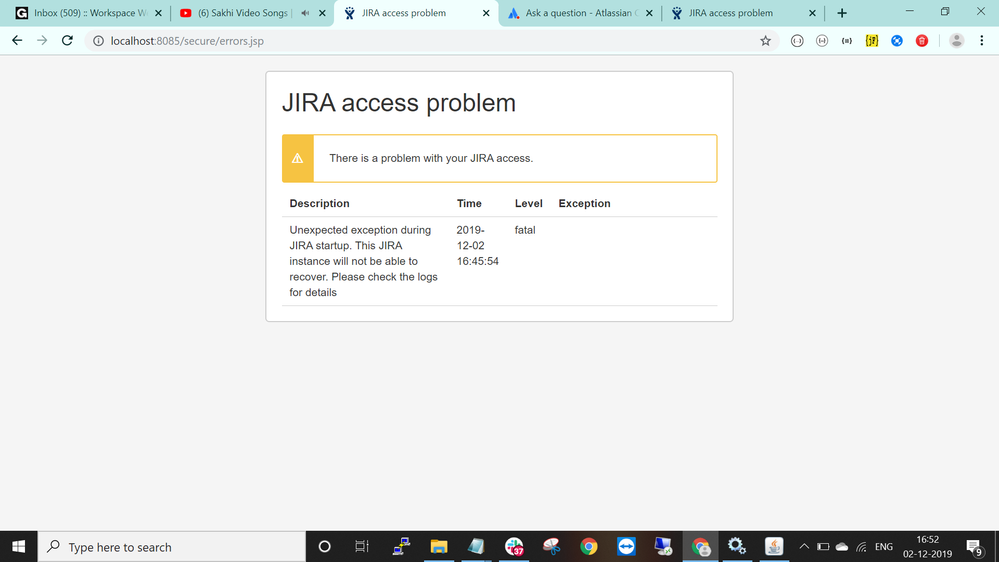

Hi team,
After upgrading jira 6.4.6 with jira 7.0 not able to start jira.
getting error like this.
2019-12-02 16:45:53,360 localhost-startStop-1 DEBUG [c.a.activeobjects.osgi.ActiveObjectsServiceFactory] getService bundle [com.pyxis.greenhopper.jira]
2019-12-02 16:45:53,380 localhost-startStop-1 INFO [c.a.j.p.e.bamboo.service.PlanStatusUpdateServiceImpl] Job 'com.atlassian.jira.plugin.ext.bamboo.service.PlanStatusUpdateServiceImpl:job' scheduled to run every 60000ms
2019-12-02 16:45:53,902 localhost-startStop-1 INFO [c.a.jira.scheduler.JiraSchedulerLauncher] Starting the JIRA Scheduler....
2019-12-02 16:45:53,933 localhost-startStop-1 INFO [c.a.jira.scheduler.JiraSchedulerLauncher] JIRA Scheduler started.
2019-12-02 16:45:54,568 localhost-startStop-1 INFO [c.a.jira.startup.EmbeddedDatabaseMigrator] Starting legacy HSQL embedded database import: C:\Program Files\Atlassian\Application Data\JIRA\export\hsql-migration.zip
2019-12-02 16:45:54,573 localhost-startStop-1 ERROR [c.a.jira.startup.LauncherContextListener] Unable to start JIRA.
java.lang.IllegalStateException: You cannot perform an import with an invalid validation result. Errors: {}
Error Messages: [This JIRA installation has already been set up. Please perform an XML restore instead of an import during setup.]

Alexis Robert
December 2, 2019
Hi @Mahendar D ,
the error message says the instance is already setup :
Can you try restarting Jira ? If you get access to the interface, you should then try to restore your XML backup from the Administration menu.
Let me know if this helps,
--Alexis
