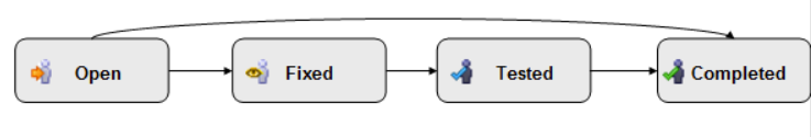

I am writing code to make 3 transitions back to back, from open to fixed, then from fixed to tested and then from tested to completed as shown in the diagram below:
The problem is that the line     IssueResult transitionResult = issueService.transition(currentUser, transitionValidationResult) is not changing the status. The status of my issue is still open even though it should be fixed at some point. How can I fix this problem?  How can I enforce the status change? I need to change the status of my issue, is there a solution?
