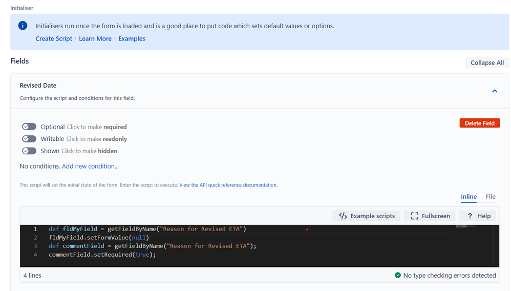

Issa
May 27, 2024
Thanks for the reply Radek,
But I have not added as initialiser. It is the server side script on the field. See below screenshots
Radek Dostál
May 27, 2024
Oh right, also reproduced.. my bad, totally forgot they changed that at some point.
