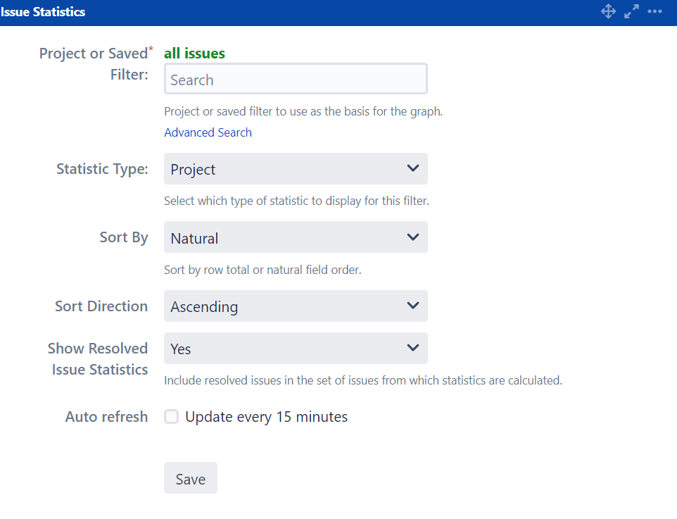

2、select 'all issue' filter , Statistic Type:project , Show Resolved Issue Statistics : YES

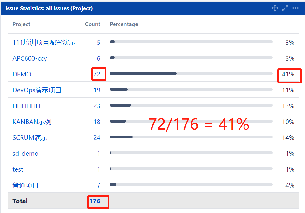

The Resolved Issue Statistics is wrong, the result is the percentage of a project issues in all projects, not the proportion of issue solved
Nic Brough -Adaptavist-
July 29, 2020
No, that's correct.  I think you may be misunderstanding what the gadget is doing.
  • You have a list of all the issues (176)
  • You have chosen to show all issues, not just "unresolved" from that list. (So all 176)
  • You have chosen to group them by project.
  • Your Demo project has 72 issues in it, which is 41% of 176.  Which is clearly correct.
  • The problem is the very last line - you say "not the proportion solved".  But you did not ask the gadget for that!  You asked it for "all issues".
What you could do is think about:
  • Grouping the issues by "resolution" or "status" instead of Project - these are indicators of whether an issue is solved or not.
  • Change the filter so that it only reports resolved (solved) issues.  Search for "resolution is not empty", save the search as a filter, then use it in the gadget.
But I don't think either of those answer your question in full.  Could you explain exactly what you want from this reporting?
