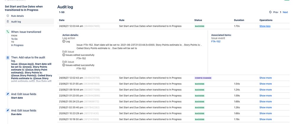

I tried this in Audit log:
Issue: {{issue.key}}. Start date will be set to: {{now}}. Story Points estimate is: {{issue.Story Point estimate}}. Story Points is: {{issue.Story Points}}. Ceiled Story Points estimate is: {{issue.Story point estimate.ceil}}. Due Date will be set to {{issue.created.plusBusinessDays(issue.Story point estimate.ceil)}}
And this is what I get:
Issue: FTA-136. Start date will be set to: 2021-06-23T06:18:44.7+0000. Story Points estimate is: . Story Points is: . Ceiled Story Points estimate is: . Due Date will be set to

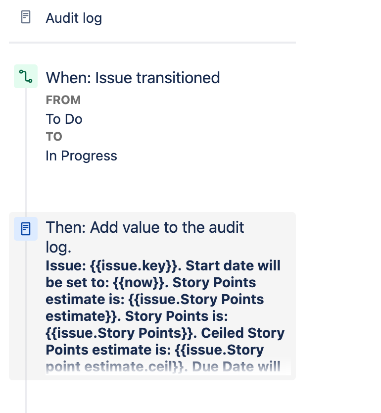

2. This is the log message format that I am using:
Issue: {{issue.key}}. Start date will be set to: {{now}}. Story Points estimate is: {{issue.Story Point estimate}}. Story Points is: {{issue.Story Points}}. Ceiled Story Points estimate is: {{issue.Story Point estimate.ceil}}. Due Date will be set to {{issue.created.plusBusinessDays(issue.Story Point estimate.ceil)}}

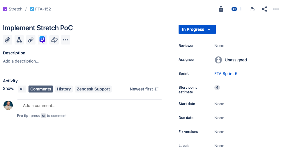

As you can see the value for Story Points estimate field is empty.
The value is set in the issue:

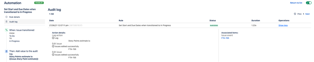

- I created a log action just with {{issue.Story Point estimate}} value and the result is the same: I don't get any value for it:

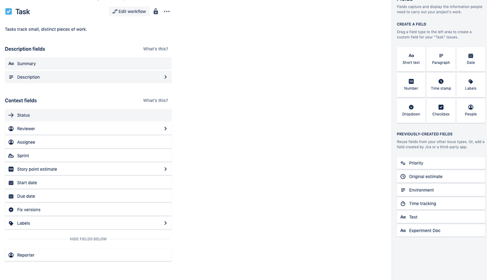

- I am the project admin and I can confirm that there is one-and-only-one field named "Story Point estimate" in our project:
