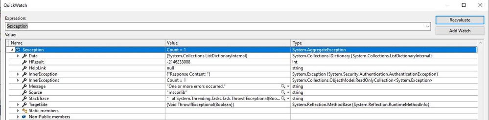

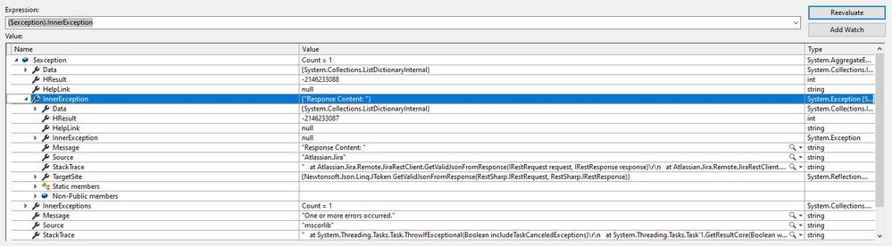

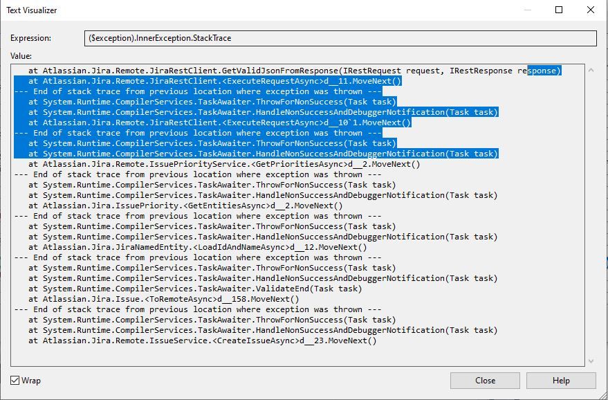

The .NET program I used to create Jira issues automatically fails to save the new created issue. But I can create and save a issue manually when I log in Jira in browser. See the attached pics for exception details. What causes this exception? thanks.
Nic Brough -Adaptavist-
April 22, 2021
This is something broken in whatever library or application you are using to talk to Jira with.  You'll need to fix your code such that it makes a valid call.  You've not told us what you're using, so we can't tell you much more than that.
April 27, 2021
It's usually the id you need.  I think you should have a look at the project though, the "change" might be that someone removed priority or changed the priority scheme.
No priority usually means "nothing selected, field is empty" though, which is usually a null, or not sending anything at all.

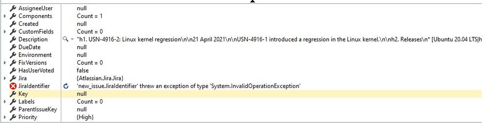

Ming Liang
April 27, 2021
I tried following two ways to set priority, but they all triggers that exception.
So, what is the correct way to do it in .net code? Thanks.
